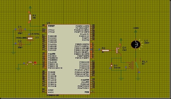

源代码:
* _3.c
* Created: 2011-4-5 19:34:47
*  Author: xmphoenix.fish
#include
#include
#define F_CPU 8000000UL
#define key_down()    (PINB &_BV(PB5))
#define real_switch()    PORTE^=_BV(PE3)
int main(void)
    DDRE = 0xff;PORTE = 0xff;
    DDRB = 0x00;PORTB = 0xff;
    while(1)
        if (!key_down())
            while(!key_down());
            real_switch();
            _delay_ms(20);
截图:
2011-4-5-20-47
