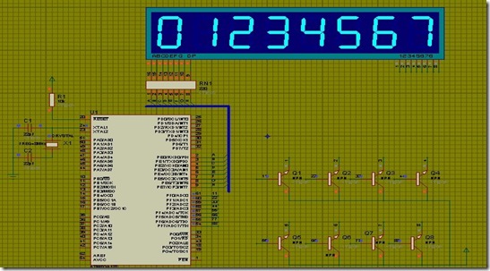

2020年01月08日 | avrstudio 5 同时点亮8只数码管
2020-01-08 来源:eefocus
avrstudio 5开发程序:
备注:
   1.在proteus的里面可以导入elf文件,来实现也就是说不一定非要生成hex文件
   2.关键点:是要消影子,这点在原来的书上是没有的,可能是编书时的错漏。
源代码:
* eight_led_return.c
* Project: eight led
* Created: 2011-3-25 12:23:09
* Author : xmphoenix.fish
#include
#include
#define F_CPU 8000000UL
//led light char
const char table[]={0xC0,0xf9,0xa4,0xb0,0x99,0x92,0x82,0xf8,0x80,0x90};
int main(void)
    char i;
    DDRE= 0xff;DDRF = 0xff;//set the port c and d for input
    PORTF=0x01;
    while(1)
        //TODO:: Please write your application code
        for (i=0;i<8;i++)
            PORTF=_BV(i);//the operation _BV() contain in system
            PORTE=table[i];
            _delay_us(2);//strip the false figure
            PORTF=0x00;
            PORTE=0xff;
            _delay_us(2);
    return 0;
截图:
