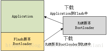

方式一、为了实现在线更新功能,Bootloader程序需要对flash进行操作。一般情况下,我们将FLASH操作程序作为Bootloader组件的一部分固化在存储器中,在需要执行flash擦除或烧写操作时,先将该部分代码复制到RAM中,再做调用。操作代码的复制工作也可以在Bootloader启动阶段完成。
方式二、两级Bootloader方案,没有在flash存储器中固化flash擦写代码,而是通过通讯口将该部分代码从上位机下载到指定的RAM出,在需要指出flash擦除或烧写操作时,再调用RAM中的该代码。
方式三、Bootloader制作下载引导程序,此软件不固化flash擦写代码,通过通讯口下载另外Bootloader(包含flash擦写操作)到指定的RAM中,跳转到RAM运行升级流程。

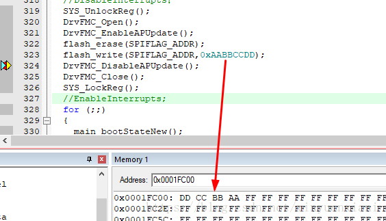

下面我们来是测试代码:
//编译生成的擦、写文件,此处直接加载到数组中,而非通过上位机下载
//__align(4) :对齐方式
__align(4) uint8_t flash_erase_buf[]={
0x01,0x46,0x22,0x20,0x11,0x4A,0xD0,0x60,0x10,0x46,0x41,0x60,0x72,0xB6,0x01,0x20,
0x10,0x61,0x00,0xBF,0x00,0xBF,0x00,0xBF,0xBF,0xF3,0x6F,0x8F,0x00,0xBF,0x00,0xBF,
0x00,0xBF,0x00,0xBF,0x09,0x48,0x00,0x69,0x00,0x28,0xFB,0xD1,0x62,0xB6,0x07,0x48,
0x00,0x68,0x40,0x22,0x10,0x40,0x00,0x28,0x06,0xD0,0x04,0x48,0x00,0x68,0x10,0x43,
0x02,0x4A,0x10,0x60,0x01,0x20,0x70,0x47,0x00,0x20,0xFC,0xE7,0x00,0xC0,0x00,0x50,
__align(4) uint8_t flash_write_buf[]={
0x02,0x46,0x21,0x20,0x12,0x4B,0xD8,0x60,0x18,0x46,0x42,0x60,0x81,0x60,0x72,0xB6,
0x01,0x20,0x18,0x61,0x00,0xBF,0x00,0xBF,0x00,0xBF,0xBF,0xF3,0x6F,0x8F,0x00,0xBF,
0x00,0xBF,0x00,0xBF,0x00,0xBF,0x0A,0x48,0x00,0x69,0x00,0x28,0xFB,0xD1,0x62,0xB6,
0x07,0x48,0x00,0x68,0x40,0x23,0x18,0x40,0x00,0x28,0x06,0xD0,0x04,0x48,0x00,0x68,
0x18,0x43,0x03,0x4B,0x18,0x60,0x01,0x20,0x70,0x47,0x00,0x20,0xFC,0xE7,0x00,0x00,
0x00,0xC0,0x00,0x50
typedef void (*flash_erase_handler)(uint32_t u32addr);
typedef void (*flash_write_handler)(uint32_t u32addr, uint32_t u32data);
flash_erase_handler flash_erase = (flash_erase_handler)(flash_erase_buf + 1); // cortex-mo 使用thumb指纹,函数地址低位为1
flash_write_handler flash_write = (flash_write_handler)(flash_write_buf + 1);
int main(void)
main_powerOnInit();
SYS_UnlockReg();
DrvFMC_Open();
DrvFMC_EnableAPUpdate();
DrvFMC_Erase(SPIFLAG_ADDR);
DrvFMC_Write(SPIFLAG_ADDR,0x88776655);
DrvFMC_DisableAPUpdate();
DrvFMC_Close();
SYS_LockReg();
//DisableInterrupts;
SYS_UnlockReg();
DrvFMC_Open();
flash_erase(SPIFLAG_ADDR);
flash_write(SPIFLAG_ADDR,0xAABBCCDD);
DrvFMC_Close();
SYS_LockReg();
//EnableInterrupts;
for (;;);
测试结果显示,的确能够写法flash中。

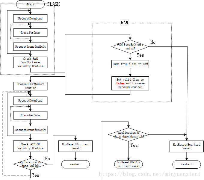

下面附上车载诊断升级示意流程图:
