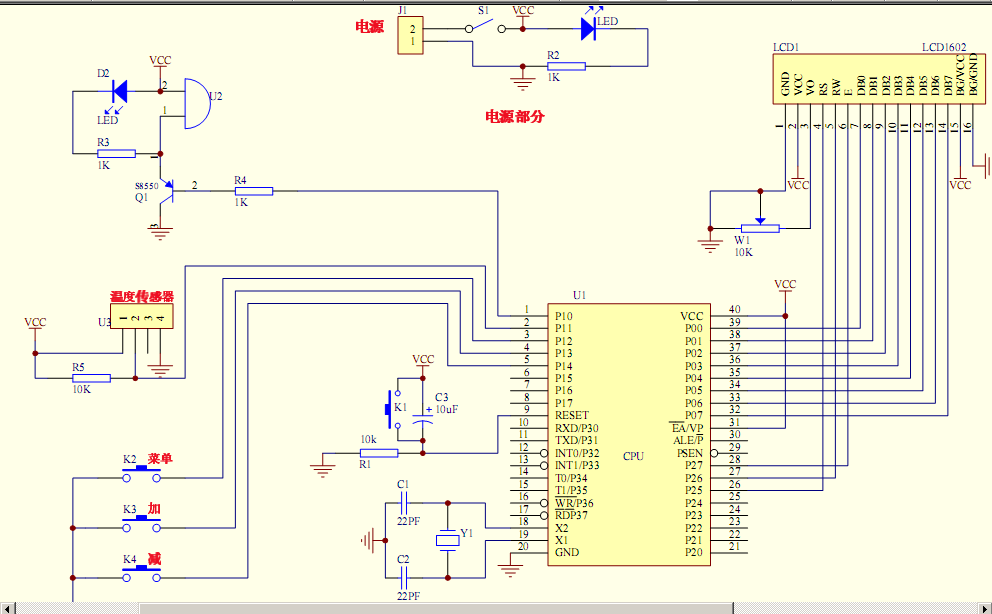

2020年01月09日 | 基于单片机的DHT11温度湿度采集系统
2020-01-09 来源:51hei
DHT11温度湿度采集原理图:
DHT11的单片机源程序:
#include
#define uint unsigned int
#define uchar unsigned char
#include
typedef bit BOOL  ;
sbit io = P1^1 ;//(口线定义)
sbit bee=P1^0;
sbit rs = P2^5 ;
sbit rw = P2^6 ;
sbit ep = P2^7 ;
bit flag_300ms ;
sbit K1=P1^2;
sbit K2=P1^3;
sbit K3=P1^4;
uchar yemian=0;//(定义变量)
uchar flat=1;
uchar data_byte;
uchar RH,RL,TH,TL;
uchar WenDu,ShiDu;//报警的温度和湿度
#include "eeprom52.h"
/****************************延时程序****************************/
void delay(uchar ms)
{       // 延时子程序
         uchar i ;
         while(ms--)
                  for(i = 0 ; i<250;i++) ;
void delay1()//延时10us
        uchar i;
        i--;
        i--;
        i--;
        i--;
        i--;
        i--;
void longdelay(uchar s) //长延时
         while(s--)
                  delay(20) ;
/******************把数据保存到单片机内部eeprom中******************/
void write_eeprom()
        SectorErase(0x2000);
        byte_write(0x2000, WenDu);
        byte_write(0x2001, ShiDu);
        byte_write(0x2060, a_a);
/******************把数据从单片机内部eeprom中读出来*****************/
void read_eeprom()
        WenDu   = byte_read(0x2000);
  ShiDu = byte_read(0x2001);
        a_a      = byte_read(0x2060);
/**************开机自检eeprom初始化*****************/
void init_eeprom()
        read_eeprom();                //先读
        if(a_a != 2)                //新的单片机初始单片机内问eeprom
        WenDu   = 30;
        ShiDu   = 80;
                a_a = 2;
                write_eeprom();
/********************报警程序部分*******************/
void warn()  //报警函数
  if(TH>=WenDu)  //检测的温度高于设定温度报警值
      bee=0; //报警
        if(RH>=ShiDu)  //检测的湿度高于设定的湿度值
      bee=0; //报警
        if( TH    {
                  bee=1; //停止报警
/************************LCD模块******************************************/
BOOL lcd_bz()//测试LCD忙碌状态
         BOOL result ;
         rs = 0 ;
         rw = 1 ;
         ep = 1 ;
         result = (BOOL)(P0 & 0x80) ;
         ep = 0 ;
         return result ;
void write_cmd(uchar cmd)// 写指令
        while(lcd_bz()) ;
        rs = 0 ;
        rw = 0 ;
        ep = 0 ;
        P0 = cmd ;
        ep = 1 ;
        ep = 0 ;
void write_addr(uchar addr)//写地址
        write_cmd(addr|0x80) ;
void write_byte(uchar dat)//写字节
        while(lcd_bz()) ;
          rs = 1 ;
          rw = 0 ;
          ep = 0 ;
          P0 = dat ;
          ep = 1 ;
          ep = 0 ;
void lcd_init()// 初始化
         write_cmd(0x38) ;
         delay(1);
         write_cmd(0x08) ;
         delay(1);
         write_cmd(0x01) ;
         delay(1);
         write_cmd(0x06) ;
         delay(1);
         write_cmd(0x0c) ;
         delay(1);
void display(uchar addr, uchar q)//在某一地址上显示一字节
         delay(1) ;
         write_addr(addr) ;
   write_byte(q) ;
         delay(1) ;
/*********************** DHT11测试模块***************************************/
void start()//开始信号
        io=1;
        delay1();
        io=0;
        delay(20);//>18ms
        io=1;
        delay1();//20-40us
        delay1();
        delay1();
        delay1();
        delay1();
uchar receive_byte()//接收一个字节
        uchar i,temp,count;
        for(i=0;i<8;i++)
        temp=0;
                delay1();delay1();delay1();delay1();
                if(io==1)temp=1;
                count=2;
                while((io)&&count++);
                if(count==1)break;
                data_byte<<=1;
                data_byte|=temp;
        return data_byte;
void receive()//接收数据
        uchar T_H,T_L,R_H,R_L,check,num_check;
        uchar count;
        start();//开始信号
        io=1;
        if(!io)//读取DHT11响应信号
        R_H=receive_byte();
        R_L=receive_byte();
        T_H=receive_byte();
        T_L=receive_byte();
        check=receive_byte();
        io=0;//拉低延时50us
        delay1();delay1();delay1();delay1();delay1();
        io=1;
        num_check=R_H+R_L+T_H+T_L;
        if(num_check=check)
                RH=R_H;
                RL=R_L;
                TH=T_H;
                TL=T_L;
                check=num_check;
void showw()   // 问候语函数
           lcd_init(); //初始化
            delay(10);
     display(0x05,'W');
     display(0x06,'e');
                 display(0x07,'l');
                 display(0x08,'c');
                 display(0x09,'o');
                 display(0x0a,'m');
     display(0x0b,'e');
           delay(250); //短暂延时
           delay(250);
           delay(250);
           display(0x40,' ') ;
                 display(0x41,'h');
                 display(0x42,'e');
/*************定时器0初始化程序***************/
void time_init()
        EA   = 1;                   //开总中断
        TMOD = 0X01;          //定时器0、定时器1工作方式1
