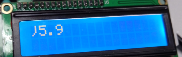

1.主代码:
/* 温度传感器  */
#include "DS18B20.h"
#include"def.h"
u16 get_temp (void)
    float tt;
    u16 temp;
    u8 a,b;
    ds_delay(40);
    dsic_init();
    write_byte(0xcc);
    write_byte(0x44);
    ds_delay(40);
    dsic_init();
    write_byte(0xcc);
    write_byte(0xbe);
    ds_delay(40);
    a = read_byte();
    b = read_byte();
    temp = b;
    temp <<= 8;
    temp = temp|a;
    tt = temp*0.0625;
    temp = tt*10+0.5;
    return temp;
void ds_delay(u16 i)
    while(--i);
void dsic_init (void)
    ds_dat = 1;
    ds_delay (2);
    ds_dat = 0;
    ds_delay (250);
    ds_dat = 1;
    ds_delay (100);
u8 read_byte (void)
    u8 i = 0;
    u8 dat = 0;
    for(i=8;i>0;i--)
        ds_dat = 0;
        _nop_();
        dat >>= 1;
        ds_dat = 1;
        ds_delay(2);
        if(ds_dat)
            dat |= 0x80;
        ds_delay(11);
    return (dat);
void write_byte(u8 dat)
    u8 i = 0;
    for(i=8;i>0;i--)
        ds_dat = 0;
        _nop_();
        ds_dat = dat&0x01;
        ds_delay(11);
        ds_dat = 1;
        dat >>= 1;
        ds_delay(2);
#include
#include"lcd1602.h"
#include"DS18B20.h"
#include"def.h"
void main(void)
    float temperature ;
    lcd_init();
    while(1)
        temperature = get_temp ();
        dispy1(temperature);
2.效果演示:
