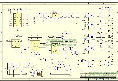

2020年01月12日 | PIC单片机对摩托车防盗报警器的设计
2020-01-12 来源:elecfans

PIC单片机对摩托车防盗报警器的设计

/**********************当PORT6.2口电平为高时调用该程序收码******************/
;PORT6.2为信号输入口
collect_2262:
MOV a,@0xf0
AndKEY_STATUS,a
clrcode_total
clrsignal_high
collect1:
incsignal_high
MOV A,SIGNAL_HIGH
SUBA,@30
JBSR3,0
RET
clrsignal_low
calldelay20us
jbsport6,2
jmpcollect_low
jmpcollect1
collect_low:
MOV a,signal_high;信号高电平宽度《80US时滤除
suba,@4
jbcr3,0
ret
MOV a,@20;信号高电平宽度在80—400US时为采集为0
suba,signal_high;信号高电平宽度在400US以上时为采集为1
rrcdata_recorder
rrccode_recorder2
rrccode_recorder1
inccode_total
clrsignal_high
MOV a,@24
xora,code_total
jbcr3,2
jmpcollect_end
input_low:
incsignal_low
MOV a,signal_low;信号低电平宽度大于800US时滤除
suba,@40
jbsr3,0
ret
calldelay20us
jbsport6,2;3
jmpinput_low
jmpcollect1
collect_end:
MOV a,code_recorder1;校验低字节地址
xora,@code_address1
jbsr3,2
ret
MOV a,code_recorder2;校验高字节地址
xora,@code_address2
jbsr3,2
ret
jbsKEY_STATUS,check_flag;是否是第一串收码?
jmpstorage_data
bcKEY_STATUS,check_flag
MOV a,com_data_rec
xora,data_recorder
jbsr3,2
jmpstorage_data
MOV a,data_recorder
xora,@autorun_value;是启动键?
jbsr3,2
jmpkey1
bsKEY_STATUS,autorun_key;置启动键标志
bsKEY_STATUS,press_flag;置有键按下标志
clrkey_counter;清除按键间隔计数器
ret
key1:
MOV a,data_recorder
xora,@open_value;是解除键?
jbsr3,2
jmpkey2
bsKEY_STATUS,open_key
clrkey_counter
ret
key2:
MOV a,data_recorder
anda,@0x0c;同时有两个键按下时不为0X30
xora,@lock_value;是防盗键?
jbsr3,2
jmpkey3
bsKEY_STATUS,lock_key
clrkey_counter
key3:
MOV a,data_recorder
anda,@0x30
xora,@search_value;是寻车键?
jbsr3,2
ret
bsKEY_STATUS,search_key
clrkey_counter
ret
storage_data:;第一次收码存储数据字节
MOV a,data_recorder
MOV com_data_rec,a
ret
delay20us:
wdtc
MOV a,@3;9
MOV delay1,a
delay20us_1:
nop
djzdelay1
jmpdelay20us_1
ret
