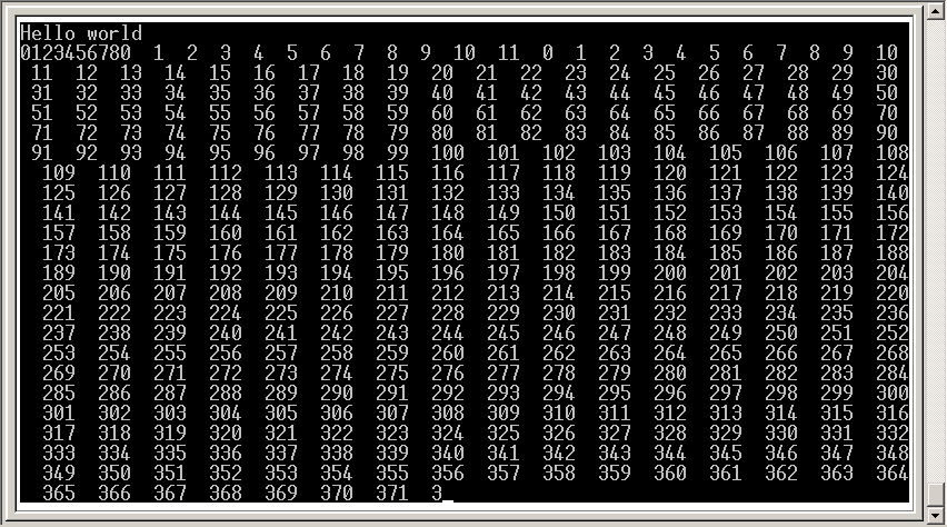

串口应该都很熟悉了,具体通信原理我就不提了,这个百度上都很多讲的,然后就直接看函数了。
void Uart_SendByte(int data)//这个函数是发送整型数据,参数为data
    if(whichUart==0)//这个是选中串口0
        if(data=='n')//然后判断数据不为空
      /*寄存器的原始宏定义,
      #define rUTRSTAT0   (*(volatile unsigned *)0x50000010) //UART 0 Tx/Rx status*/
            while(!(rUTRSTAT0 & 0x2));/*这个就是查询串口0的状态寄存器,第1位是发送缓冲器是否为空
            第二位是Transmit buffer empty
            0 = The buffer register is not empty
            1 = Empty     这里检查为0的话就是还没发送完全,当置1的时候表示发完了,程序继续执行*/
            Delay(10);                 //because the slow response of hyper_terminal
            WrUTXH0('r');
        while(!(rUTRSTAT0 & 0x2));   //Wait until THR is empty.
        Delay(10);
        WrUTXH0(data);
    else if(whichUart==1)
        if(data=='n')
            while(!(rUTRSTAT1 & 0x2));
            rUTXH1 = 'r';
        while(!(rUTRSTAT1 & 0x2));   //Wait until THR is empty.
        Delay(10);
        rUTXH1 = data;
    else if(whichUart==2)
        if(data=='n')
            while(!(rUTRSTAT2 & 0x2));
            rUTXH2 = 'r';
        while(!(rUTRSTAT2 & 0x2));   //Wait until THR is empty.
        Delay(10);
        rUTXH2 = data;

void Main(void)
    U8 count_num = 0;
    char *mode;
    int i;
    U8 key;
    U32 mpll_val = 0 ;
    //U32 divn_upll = 0 ;
    #if ADS10
//  __rt_lib_init(); //for ADS 1.0
    #endif
    Port_Init();//端口初始化
    Isr_Init();//中断初始化
    i = 2 ; //don't use 100M!
        //boot_params.cpu_clk.val = 3;
    //确定频率
    switch ( i )
        case 0: //200
            key = 12;
            mpll_val = (92<<12)|(4<<4)|(1);
            break;
        case 1: //300
            key = 13;
            mpll_val = (67<<12)|(1<<4)|(1);
            break;
        case 2: //400
            key = 14;
            mpll_val = (92<<12)|(1<<4)|(1);
            break;
        case 3: //440!!!
            key = 14;
            mpll_val = (102<<12)|(1<<4)|(1);
            break;
        default:
            key = 14;
            break;
    //init FCLK=400M, so change MPLL first
    ChangeMPllValue((mpll_val>>12)&0xff, (mpll_val>>4)&0x3f, mpll_val&3);
    ChangeClockDivider(key, 12);
    cal_cpu_bus_clk();
    consoleNum = 0; // Uart 1 select for debug.选择串口号
    Uart_Init( 0,115200 );//初始化串口参数以及时钟源
    Uart_Select( consoleNum );//选择串口号

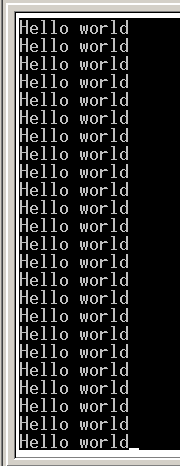

    Beep(2000, 100);//蜂鸣器
    Uart_SendByte('n');//打印信息
    Uart_SendByte('H');
    while(1)
        Uart_SendByte(count_num);
        Uart_SendByte(' ');
        count_num ++;
        Delay(500);

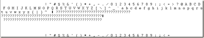

从而让ARM一直向PC机发送从0-255数据,在PC机中显示结果如下:
串口截图

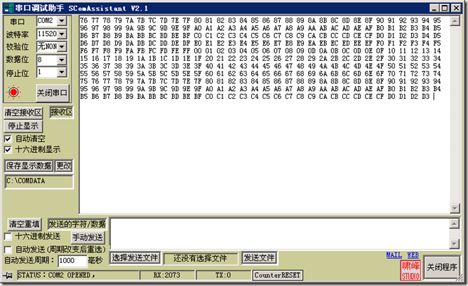

这个看不了十六进制的数,我搞了个串口助手来显示:
串口助手显示十六进制

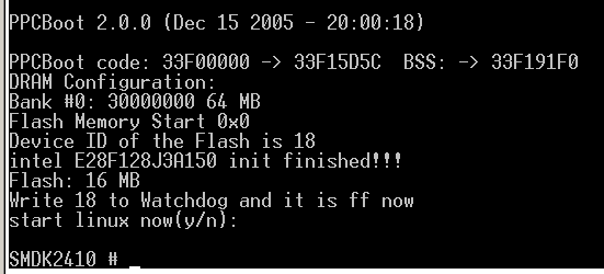

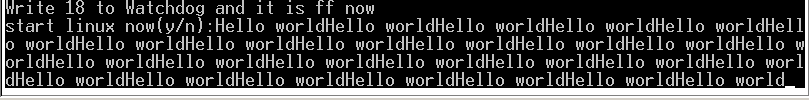

上面那个是用mini2440实现的,那个通过UBOOT可以直接烧写程序,不过到了华恒的板子我就不知道为啥了,这个苦闷了我好久,今天在进入PPCBOOT中利用erase命令把那个linux系统檫除了,然后进入ppcboot命令行形式才可以jtag调试,不知道为啥,这次终于进了一次调试结果出来了。
下面出一张计数的图,感觉下成就感吧,虽然底层函数还没完全弄懂!
 现在总结这些步骤吧,最开始在上电的时候不要立马启动系统,先要进入PPCBOOT模式命令行,然后再启动AXD调试器。
通过H-JATG软件可以看到是小端格式的,但是具体怎么设置暂时还不清楚,
#define WrUTXH0(ch) (*(volatile unsigned char *)0x50000020)=(unsigned char)(ch)
 WrUTXH0即是写UTXH0的意思,UTXH0是第一个串口的发送缓冲寄存器!
