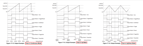

2.2 PWM输出
2.2.1 PWM计数模式
#define TIMER_MC_STOP         (0)  /* Timer A mode control: 0 - Stop */
#define TIMER_MC_UP           (1)  /* Timer A mode control: 1 - Up to CCR0 */
#define TIMER_MC_CONTINUOUS   (2)  /* Timer A mode control: 2 - Continuous up */
#define TIMER_MC_CONTINOUS    (2)  /* Legacy define */
#define TIMER_MC_UPDOWN       (3)  /* Timer A mode control: 3 - Up/Down */
2.2.2 PWM输出模式
typedef enum
  TIMER_PWM_OUTMOD0     ,
  TIMER_PWM_OUTMOD1     ,
  TIMER_PWM_OUTMOD2     ,
  TIMER_PWM_OUTMOD3     ,
  TIMER_PWM_OUTMOD4     ,
  TIMER_PWM_OUTMOD5     ,
  TIMER_PWM_OUTMOD6     ,
  TIMER_PWM_OUTMOD7     ,
}TIMER_PWM_OUTMODn;       //PWM波输出波形
各种计数情况下pwm输出模式
2.3 pwm输出
