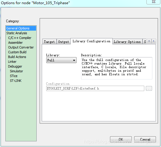

同时需要修改IAR的Projec t- >Options -> General Options -> Library Configuration中的Library 项由"Normal"改为"Full"。

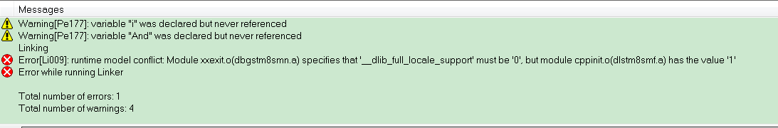

如果IAR 编译出现Error[Li009]: runtime model conflict: Module xxexit.o(dbgstm8smn.a) specifies that '__dlib_full_locale_support' must be '0', but module cppinit.o(dlstm8smf.a) has the value '1'
runtime model conflict:应该是编译链接时,工程设置有问题

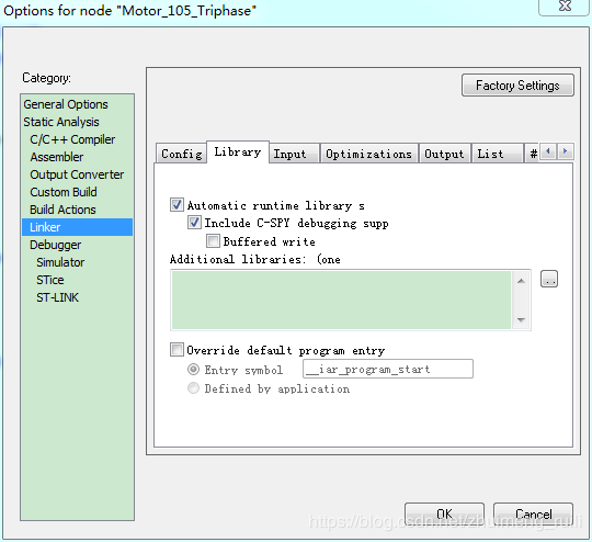

解决方法是:在option -> linker -> library 中勾上 Include C-SPY debugging support, 就OK了
