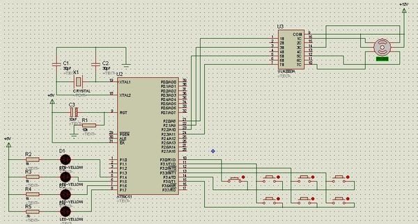

电路图:
程序;
#include
#define uint unsigned int
#define uchar unsigned char
uchar code  s[]={  0x88,0x22,0x44,0x11 };
void delay(uint z)
{ uint x,y;
for(x=z;x>0;x--)
  for(y=110;y>0;y--);
void main()
{ int i;
   while(1)
    {  for(i=0;i<4;i++)
       {   P2=s[i];
           delay(200);

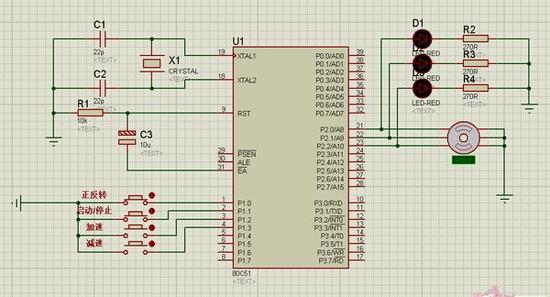

#include
sbit k1=P1^1; //启动
sbit k2=P1^0; //正反转
sbit k3=P1^2; //加速
sbit k4=P1^3; //减速
unsigned int x=50000;
unsigned char i=0;
unsigned char code table[6]={0x01,0x03,0x02,0x06,0x04,0x05};//单双六拍
void motor();
void main()
TMOD=0x01;
TH0=-x>>8;                  //
TL0=-x%256;                  //
TCON=0x10;
IE=0x82;
while(1);
void time_0 () interrupt 1
EA=0;TR0=0;
motor();
if(x<65000&&x>36000)          //上下限
{if(!k3) x=x-2000;                  //加速
else if(!k4) x=x+2000;}    //减速
TH0=-x>>8;TL0=-x%256;
TR0=1;EA=1;
void motor()
if(!k1)
{ if(!k2)                 //正反转
{i+=1;
if(i>5) i=0;}
else
{i-=1;
if(i>5) i=5;}
P2=table;
else P2=0;
