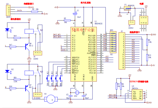

2020年02月24日 | 单片机粮仓温湿度控制系统
2020-02-24 来源:51hei
给大伙分享一个51单片机做粮仓温湿度控制系统,下面是原理图基于dht11传感器做的.
单片机源程序如下:

* 名称 : Main()
* 功能 : 主函数
void main()
    U16 i, j, testnum;
    EA = 0;
        Timer0_Init();  //定时器0初始化
    Data_Init();
        EA = 1;
        L1602_init();
        L1602_string(1,1," Welcome to T&H   ");
        L1602_string(2,1," Control System!  ");
        //延时
        for (i=0;i<500;i++)
           for (j=0;j<1000;j++)
    //清屏
        L1602_string(1,1,"                ");
        L1602_string(2,1,"                ");
    L1602_string(1,1,"Tem:    C  TH:");
        L1602_string(2,1,"Hum:    %  HH:");
    //载入温度上限和湿度上限设定值
        Load_Setting();
        L1602_char(1, 15, TH/10+48);
        L1602_char(1, 16, TH%10+48);
        L1602_char(2, 15, HH/10+48);
        L1602_char(2, 16, HH%10+48);
        while(1)
       //温湿度转换标志检查
                 if (FlagStartRH == 1)
                     TR0 = 0;
             testnum = RH();
                         FlagStartRH = 0;
                         TR0 = 1;
             //读出温湿度,只取整数部分
                         humidity = U8RH_data_H;
                         temperature = U8T_data_H;
                         //显示温湿度
                         L1602_int(1,5,temperature);
                     L1602_int(2,5,humidity);
                //温湿度控制
                if (temperature > TH) Led_jiangwen = 0;
