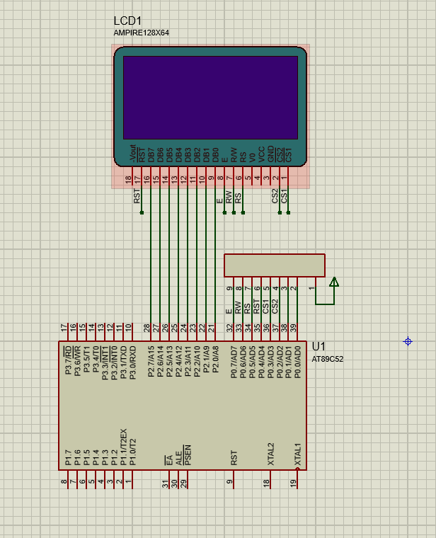

2020年02月26日 | LCD12864(KS0108)驱动程序 显示汉字-字符
2020-02-26 来源:51hei
仿真原理图如下

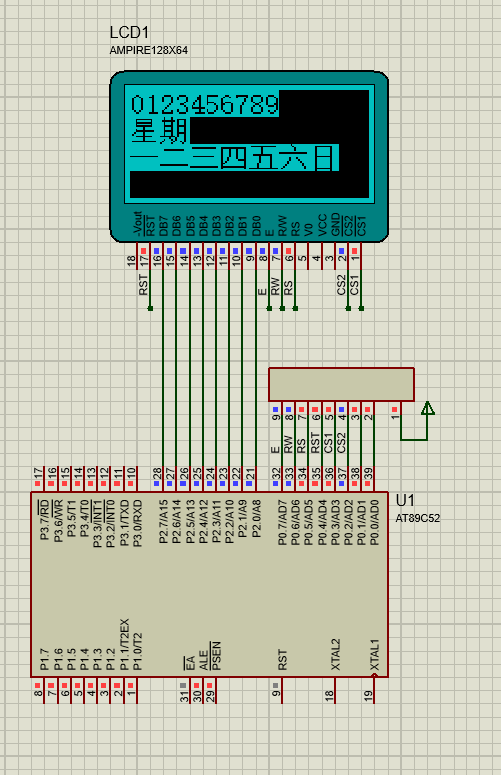

void main(void)
          init_lcd();     //初始化
          lcd_Clr_Scr();  //清屏
        while(1)
                lcd_write_english(0,0,0,SHUZI);
                lcd_write_english(0,8,1,SHUZI);
                lcd_write_english(0,16,2,SHUZI);
                lcd_write_english(0,24,3,SHUZI);
                lcd_write_english(0,32,4,SHUZI);
                lcd_write_english(0,40,5,SHUZI);
                lcd_write_english(0,48,6,SHUZI);
                lcd_write_english(0,56,7,SHUZI);
                lcd_write_english(0,64,8,SHUZI);
                lcd_write_english(0,72,9,SHUZI);
                lcd_write_chinese(2,0,0,HANZI);
                lcd_write_chinese(2,16,1,HANZI);
                lcd_write_chinese(4,0,2,HANZI);
                lcd_write_chinese(4,16,3,HANZI);
                lcd_write_chinese(4,32,4,HANZI);
                lcd_write_chinese(4,48,5,HANZI);
                lcd_write_chinese(4,64,6,HANZI);
                lcd_write_chinese(4,80,7,HANZI);
                lcd_write_chinese(4,96,8,HANZI);
                while(1);
