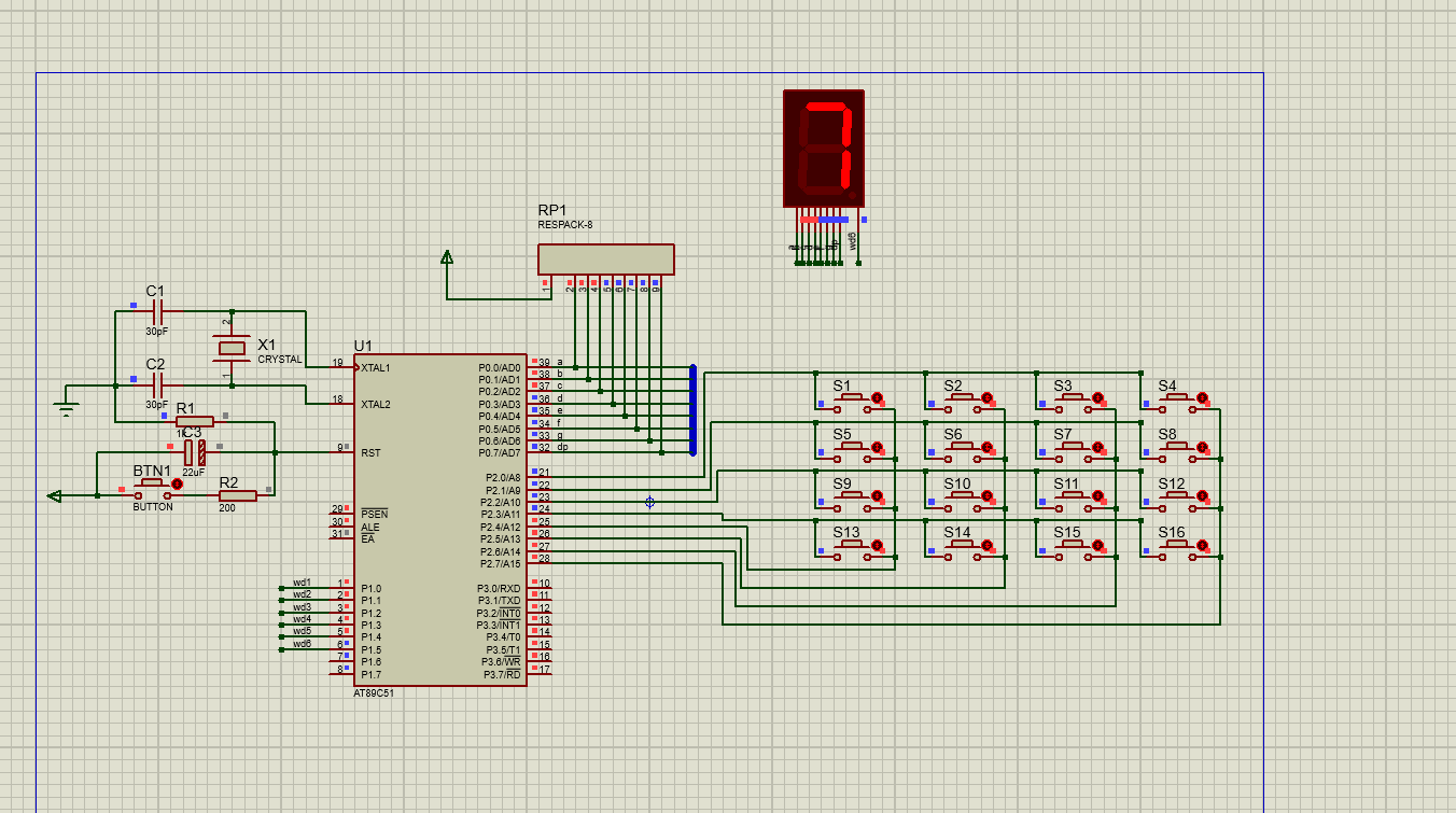

2020年03月02日 | 4*4矩阵按键《行列反转法》扫描依次显示0-f
2020-03-02 来源:51hei
数码管采用共阴数码管;
proteus电路接法如下:
程序如下:
void key_scan()          //按键扫描函数
        unsigned char code table[] = {0x3f,0x06,0x5b,0x4f,0x66,0x6d,0x7d,0x07,0x7f,0x6f,0x77,0x7c,0x39,0x5e,0x79,0x71};
        P2 = 0xf0;          //列扫描
        if(P2 != 0xf0)
                delay(1000);
                if(P2 != 0xf0)
                        P2 = 0xef;
                //        delay(10000);
                        if(P2 != 0xef)      //第一行扫描
                                switch(P2)
                                        case 0xee: P1 = 0x1f; P0 = table[0]; break;
                                        case 0xed: P1 = 0x1f; P0 = table[4]; break;
                                        case 0xeb: P1 = 0x1f; P0 = table[8]; break;
                                        case 0xe7: P1 = 0x1f; P0 = table[12]; break;
                        P2 = 0xdf;
                        if(P2 != 0xdf)
                                switch(P2)
                                        case 0xde: P1 = 0x1f; P0 = table[1]; break;
                                        case 0xdd: P1 = 0x1f; P0 = table[5]; break;
                                        case 0xdb: P1 = 0x1f; P0 = table[9]; break;
                                        case 0xd7: P1 = 0x1f; P0 = table[13]; break;
                        P2 = 0xbf;
                        if(P2 != 0xbf)
                                switch(P2)
                                        case 0xbe: P1 = 0x1f; P0 = table[2]; break;
                                        case 0xbd: P1 = 0x1f; P0 = table[6]; break;
                                        case 0xbb: P1 = 0x1f; P0 = table[10]; break;
                                        case 0xb7: P1 = 0x1f; P0 = table[14]; break;
                        P2 = 0x7f;
                        if(P2 != 0x7f)
                                switch(P2)
                                        case 0x7e: P1 = 0x1f; P0 = table[3]; break;
                                        case 0x7d: P1 = 0x1f; P0 = table[7]; break;
                                        case 0x7b: P1 = 0x1f; P0 = table[11]; break;
                                        case 0x77: P1 = 0x1f; P0 = table[15 ]; break;
void main()
        while(1)
                key_scan();
