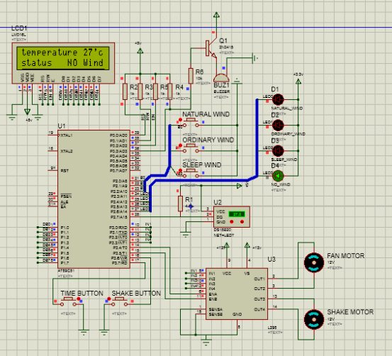

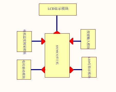

2、硬件电路
2.1电路系统框图

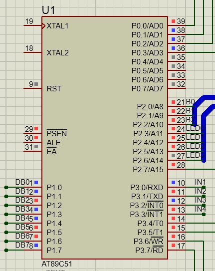

2.2 STC89C52RC最小系统

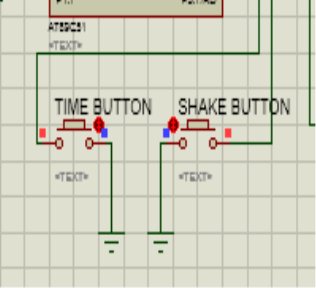

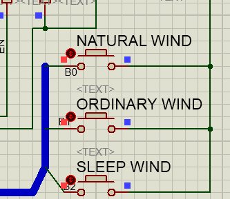

2.3 按键模块
TIME BUTTON:定时按钮
SHAKE BUTTON:摇头按钮
NATURAL WIND 自然风按钮
ORDINARY WIND 常风按钮
SLEEP WIND  睡眠风按钮

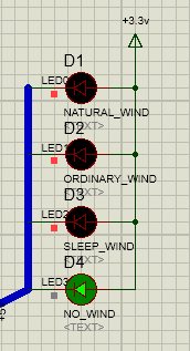

2.4 LED指示灯模块
NATURAL WIND 自然风指示灯
ORDINARY WIND 常风指示灯
SLEEP WIND 睡眠风指示灯
NO WIND 无风指示灯

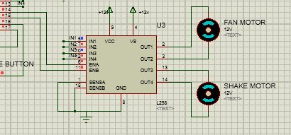

2.6 电机驱动模块
采用LM298N驱动芯片驱动两个直流电机

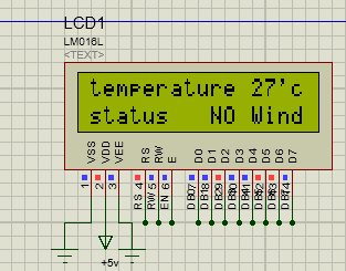

2.7 LCD显示模块
采用LCD1206输出显示当前状态

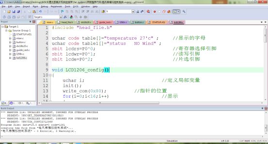

3.2 按键模块驱动程序
#include "head_file.h"
sbit Natural_wind_button  =P2^0;
sbit Ordinary_wind_button              =P2^1;
sbit Sleep_wind_button                            =P2^2;
sbit Time_button          =P3^6;
sbit Shake_button         =P3^7;

3.3 LED指示灯驱动程序
sbit Natural_wind_LED                                          =P2^3;
sbit Ordinary_wind_LED                            =P2^4;
sbit Sleep_wind_LED                                                        =P2^5;
sbit NO_Wind_LED                                                                      =P2^6;
sbit Buzzer               =P0^3;
void GUIDE_Led_Config()
                                          Natural_wind_LED = 1;
      Ordinary_wind_LED = 1;
      Sleep_wind_LED = 1;
      NO_Wind_LED = 0;
                                          Buzzer = 0;
4、调试结果

附录一:总电路仿真

电机驱动程序
uchar t0, add0;
uchar t1,add1;
sbit EN0=P3^4;
sbit EN1=P3^5;
sbit IN0=P3^0;
sbit IN1=P3^1;
sbit IN2=P3^2;
sbit IN3=P3^3;
void L298_Config()
                 t0=50;
                 t1=50;
                 IN0=0;
                 IN1=1;
                 IN2=0;
           IN3=1;
void TIM_Config()
                TMOD = 0x11;
    TH0 = (65536-50000)/256;;
    TL0 = (65536-50000)%256;;
    ET0 = 1;
    TR0 = 1;
                TH1 = (65536-50000)/256;;
                TL1 = (65536-50000)%256;;
                ET1 = 1;
    TR1 = 1;
                EA = 1;
void TIM0() interrupt 1
                         TH0=(65536-50000)/256;
       TL0=(65536-50000)%256 ;
       if(add0==100)
            add0=0;
                                                EN0=1;
       if(add0==t0)
                                                EN0=0;
                         add0++;
void TIM1() interrupt 3
                         TH1=(65536-50000)/256;
       TL1=(65536-50000)%256 ;
       if(add1==100)
            add1=0;
                                                EN1=1;
       if(add1==t1)
                                                EN1=0;
                         add1++;
