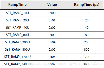

可以通过SetTxParams函数设置PA的输出能量和启动时间(10us到3.4ms)

PA启动时间见下表:

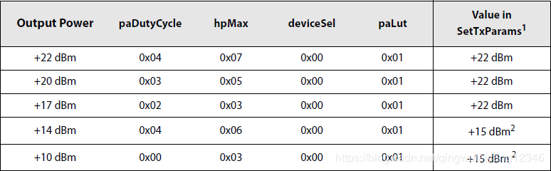

三、SetPaConfig函数
其具有4个参数,第3-4参数为固定值,不需理会。1和2的具体取值,可参考下表,最后1列表示SetTxParam函数中设定的数值。

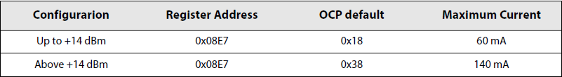

有了上述准备后,还需注意数据文档中的一些内容,原文如下:
However, to avoid consuming too much energy, the user is free to configure the Over Current Protection (OCP) register manually. At Reset, the OCP is configured to limit the current at 60 mA.(为了避免过大的能量损耗,我们还可手动配置OCP即初期,在复位后,其配置为最大60mA)
The OCP is configurable by steps of 2.5 mA and the default value is re-configured automatically each time the function SetPaConfig(...) is called. If the user wants to adjust the OCP value, it is necessary to change the register as a second step after
calling the function SetPaConfig(...).(OCP的步长为2.5mA,每次调用SetPaConfig函数会自动重新配置。假如用户想调整OCP值,需要在SetPaConfig后,改变OCP寄存器的值)

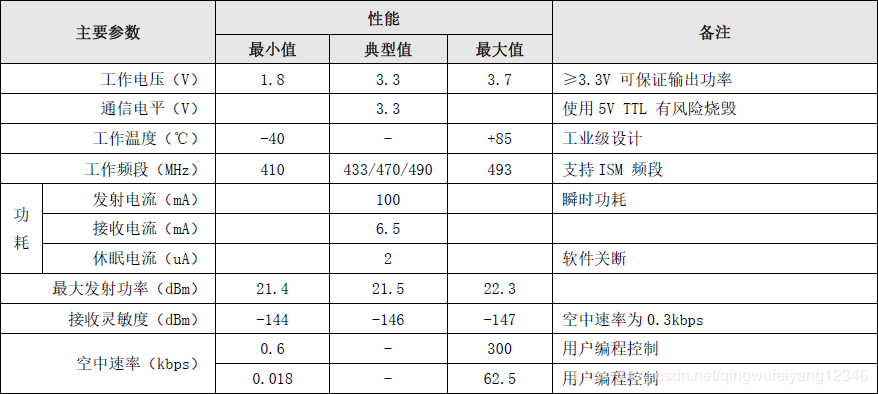

OCP与硬件设计相关,不同的硬件设计对应不同的硬件电路,查看E22-400M22S数据手册可知,其最大发射功率22dBm,所以我们可以按照22dBm进行配置。

typedef enum
    RADIO_RAMP_10_US                        = 0x00,
    RADIO_RAMP_20_US                        = 0x01,
    RADIO_RAMP_40_US                        = 0x02,
    RADIO_RAMP_80_US                        = 0x03,
    RADIO_RAMP_200_US                       = 0x04,
    RADIO_RAMP_800_US                       = 0x05,
    RADIO_RAMP_1700_US                      = 0x06,
    RADIO_RAMP_3400_US                      = 0x07,
}RadioRampTimes_t;
void SX126xSetPaConfig(uint8_t paDutyCycle, uint8_t hpMax);
void SX126xSetTxParams(int8_t power, RadioRampTimes_t rampTime);
void CSX1268::SX126xSetPaConfig(uint8_t paDutyCycle, uint8_t hpMax)
uint8_t buf[4];
buf[0] = paDutyCycle;
buf[1] = hpMax;
buf[2] = 0x00;
buf[3] = 0x01;
SX126xWriteCommand(RADIO_SET_PACONFIG, buf, 4 );
void CSX1268::SX126xSetTxParams(int8_t power, RadioRampTimes_t rampTime)
uint8_t buf[2];
SX126xSetPaConfig(0x04, 0x07);
if(power > 22)
power = 22;
else if(power < -9)
power = -9;
SX126xWriteRegister(REG_OCP, 0x38);
buf[0] = power;
buf[1] = ( uint8_t )rampTime;
SX126xWriteCommand(RADIO_SET_TXPARAMS, buf, 2);
