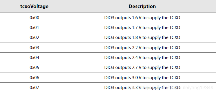

六、E22-400M22S
E22-400M22S内部使用DIO3为TCXO供电,应调用SetDIO3asTCXOCtrl命令,使能后方可给有源晶振供电。
七、SetDIO3AsTCXOCtrl函数

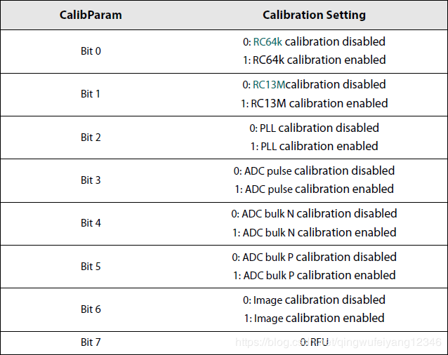

八、校准
九、程序实现
typedef enum
    TCXO_CTRL_1_6V                          = 0x00,
    TCXO_CTRL_1_7V                          = 0x01,
    TCXO_CTRL_1_8V                          = 0x02,
    TCXO_CTRL_2_2V                          = 0x03,
    TCXO_CTRL_2_4V                          = 0x04,
    TCXO_CTRL_2_7V                          = 0x05,
    TCXO_CTRL_3_0V                          = 0x06,
    TCXO_CTRL_3_3V                          = 0x07,
}RadioTcxoCtrlVoltage_t;
typedef union
    struct
        uint8_t RC64KEnable    : 1;                             //!< Calibrate RC64K clock
        uint8_t RC13MEnable    : 1;                             //!< Calibrate RC13M clock
        uint8_t PLLEnable      : 1;                             //!< Calibrate PLL
        uint8_t ADCPulseEnable : 1;                             //!< Calibrate ADC Pulse
        uint8_t ADCBulkNEnable : 1;                             //!< Calibrate ADC bulkN
        uint8_t ADCBulkPEnable : 1;                             //!< Calibrate ADC bulkP
        uint8_t ImgEnable      : 1;
        uint8_t                : 1;
    }Fields;
    uint8_t Value;
}CalibrationParams_t;
void SX126xSetDio3AsTcxoCtrl(RadioTcxoCtrlVoltage_t tcxoVoltage, uint32_t timeout);
void SX126xCalibrate(CalibrationParams_t calibParam);
void CSX1268::SX126xSetDio3AsTcxoCtrl(RadioTcxoCtrlVoltage_t tcxoVoltage, uint32_t timeout)
uint8_t buf[4];
buf[0] = tcxoVoltage & 0x07;
buf[1] = (uint8_t)((timeout >> 16) & 0xFF);
buf[2] = (uint8_t)((timeout >> 8) & 0xFF);
buf[3] = (uint8_t)(timeout & 0xFF);
SX126xWriteCommand(RADIO_SET_TCXOMODE, buf, 4);
void CSX1268::SX126xCalibrate(CalibrationParams_t calibParam)
SX126xWriteCommand(RADIO_CALIBRATE, ( uint8_t* )&calibParam, 1);
