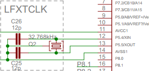

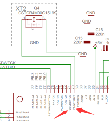

首先查看开发板原理图,搞清楚硬件连接,可以看到,单片机在XIN(P5.4)和XOUT(P5.5)引脚接了一个32.768K的手表晶振,在XT2IN(P5.2)和XT2OUT(P5.3)处接了一个4M的有源晶振;

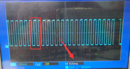

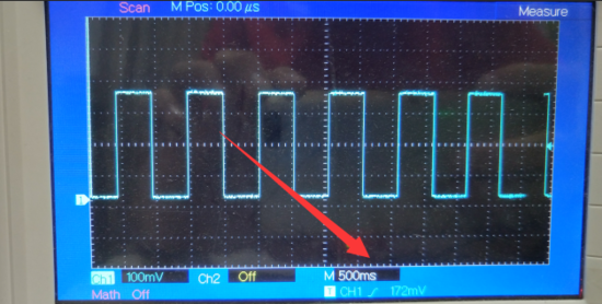

  接下来将时钟信号输出到示波器上验证一下,MCLK输出复用P7.7脚,SMCLK输出复用P2.2脚,ACLK复用P1.0脚,实验板上只引出P1.0和P2.2,所以我们只测试ACLK和SMCLK,可以看到ACLK = 32.86khz,SMCLK = MCLK = 1.05Mhz,LED闪烁频率大约为1hz;
 1 #include
 3 int main(void)
 4 {
 5     volatile unsigned int i;    //循环变量
 6     WDTCTL = WDTPW | WDTHOLD;    // stop watchdog timer
 7     P4DIR |= (BIT1+BIT7);       //P4.7观察现象,P4.1用于示波器观测
 8     P4OUT |= (BIT1+BIT7);       //输出高电平,点亮LED
 9     P1DIR |= BIT0;
10     P1SEL |= BIT0;              //P1.0输出ACLK
11     P2DIR |= BIT2;
12     P2SEL |= BIT2;              //P2.2输出SMCLK
13     while(1)
14     {
15         P4OUT ^= (BIT1+BIT7);   //LED状态取反
16         for(i = 50000;i>0;i--); //delay
17     }
18 }

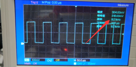

1、修改时钟源,将ACLK配置为VLOCLK内部超低功耗振荡器,可以看到,ACLK = VCOCLK = 9.21Khz
加入这行代码:
UCSCTL4 |= SELA_1;          //配置ACLK = VCOCLK

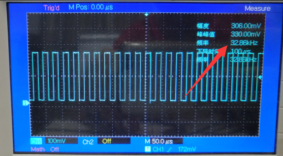

2、修改时钟源,配置ACLK为REFOCLK,内置调整低频参考振荡器,可以看到,ACLK = REFOCLK = 32.86Khz
UCSCTL4 |= SELA_2;          //配置ACLK = REFOCLK

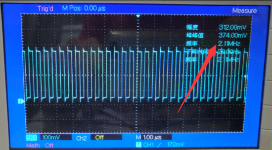

3、修改时钟源,配置ACLK为DCOCLK,可以看到,ACLK = DCOCLK = 2.11Mhz
UCSCTL4 |= SELA_3;          //配置ACLK = DCOCLK

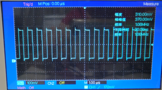

4、修改时钟源,配置ACLK为DCOCLKDIV,可以看到,ACLK = DCOCLKDIV = 1.06Mhz
UCSCTL4 |= SELA_4;          //配置ACLK = DCOCLKDIV

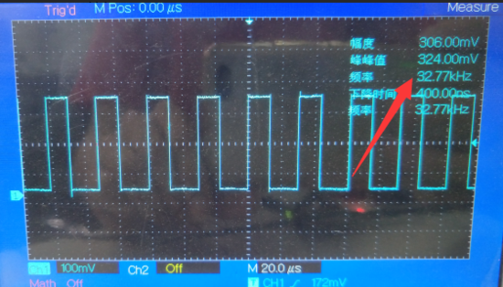

1、修改时钟源,配置ACLK = 32.768Khz,MCLK = SMCLK = DCOCLKDIV=1.05M;
#include
int main(void)
    P1DIR |= BIT0;
    P2DIR |= BIT2;
    P5SEL   |= BIT4+BIT5;       //P5.4和P5.5选择XT1晶振功能
    UCSCTL3 |= SELREF_0;        //设置FLL参考时钟源为XT1
    do
       UCSCTL7 &= ~(XT2OFFG + XT1LFOFFG + DCOFFG);
                                //清除XT2,XT1,DCO故障失效标志位
       SFRIFG1 &= ~OFIFG;       //清除晶振故障失效中断标志位
    }while(SFRIFG1&OFIFG);      //晶振故障失效中断标志位
    UCSCTL6 &= ~XT1DRIVE_0;     //减少XT1驱动能力
    UCSCTL4 |= SELA_0;          //ACLK = XT1CLK
    while(1)

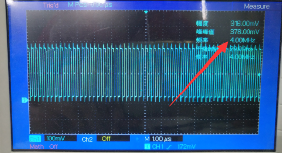

2、修改时钟源,配置ACLK = MCLK = SMCLK = XT2CLK =4Mhz
#include
int main(void)
    P1DIR |= BIT0;
    P2DIR |= BIT2;
    P5SEL   |= BIT2+BIT3;       //P5.2和P5.3选择XT2晶振功能
    UCSCTL3 |= SELREF_5;        //设置FLL参考时钟源为XT2CLK
    UCSCTL4 |= SELA_5;          //必须要设置这一句配置ACLK = XT2CLK
    do
    UCSCTL6 &= ~XT2DRIVE_0;     //XT2 = 4M,减少XT2驱动能力
    UCSCTL4 |= SELS_5 + SELM_5; //配置MCLK = SMCLK = XT2CLK
    while(1)
 示波器观测结果,可以看到LED闪烁频率也比之前加快4倍:
