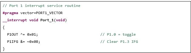

#pragma vector=PORT1_VECTOR
__interrupt void Port_1(void)
  P1OUT ^= BIT6;                            // P1.0 = toggle
  P1IFG &= ~0x08;                           // Clear P1.3 IFG
