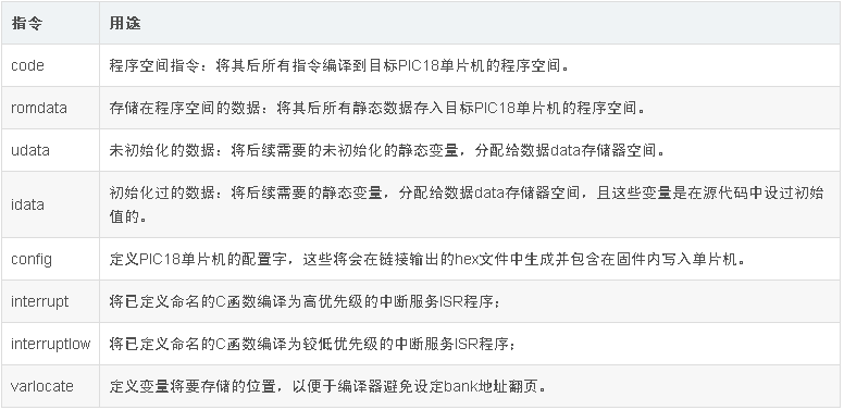

MPLAB® C18 #pragma DIRECTIVES
image.png?imageView2/2/w/550
详细内容要参见C18 User's Guide用户参考手册!
