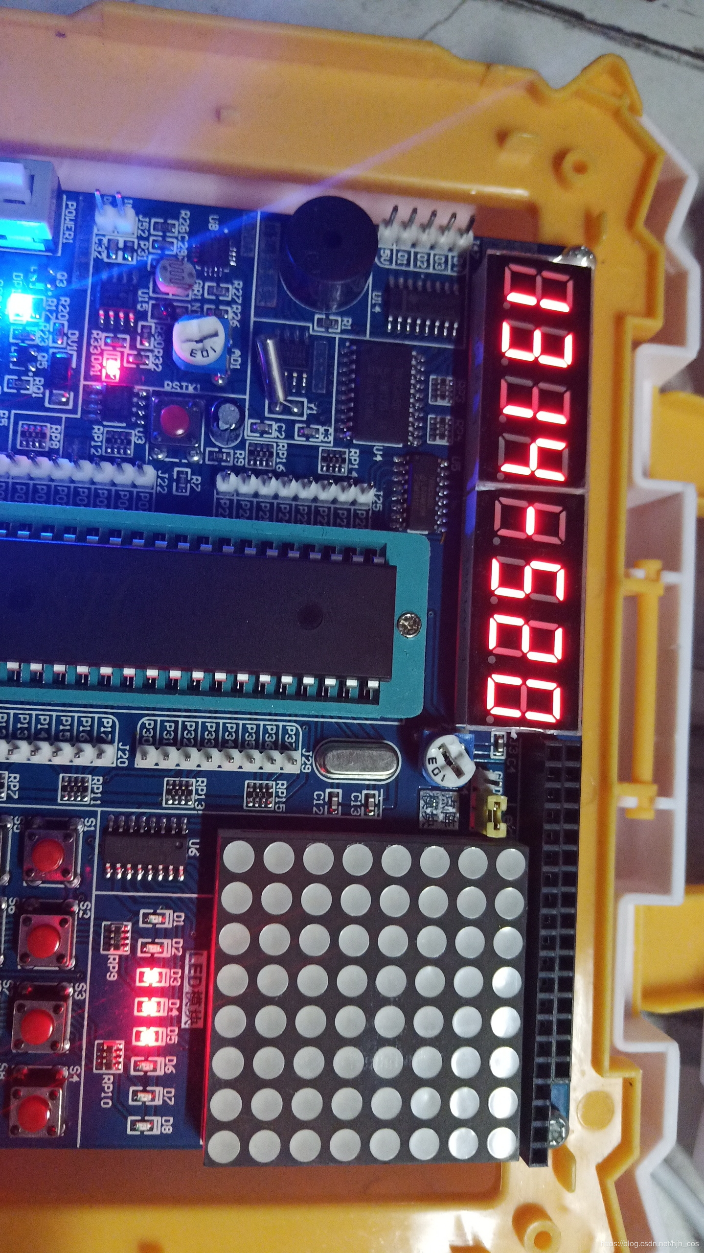

2020年04月06日 | 数码管显示1314-520(普中51-单核-A2)
2020-04-06 来源:eefocus
#include
#include
typedef unsigned int uint;
typedef unsigned char uchar;
#define LED P0
sbit tube2=P2^2;
sbit tube3=P2^3;
sbit tube4=P2^4;
uint code num[]={0x3f , 0x06 , 0x5b , 0x4f , 0x66 , //高电平控制亮   //显示数字
0x6d , 0x7d , 0x07 , 0x7f , 0x6f };
void delay(uint i);
void run();
void main(){
while(1){
run();
void delay(uint i){
while(i--);
void run(){
tube2=1;tube3=1;tube4=1;
LED=num[1];
delay(100);
tube2=0;tube3=1;tube4=1;
LED=num[3];
delay(100);
tube2=1;tube3=0;tube4=1;
LED=num[1];
delay(100);
tube2=0;tube3=0;tube4=1;
LED=num[4];
delay(100);
tube2=1;tube3=1;tube4=0;
LED=0x40;
delay(100);
tube2=0;tube3=1;tube4=0;
LED=num[5];
delay(100);
tube2=1;tube3=0;tube4=0;
LED=num[2];
delay(100);
tube2=0;tube3=0;tube4=0;
LED=num[0];
delay(100);
在这里插入图片描述
