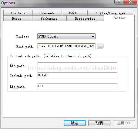

1、STVD->Tools->Options->Toolset->Root path中添加 编译器路径问题
1)可能会报错为  -clDebug -coDebug main.c " has failed, the returned value is: 1 exit code=1.
2) can't open file libm0.sm8
3)生成hex文件修改方法
project>settings>post-Build>添加
chex -o $(OutputPath)$(TargetSName).hex $(OutputPath)$(TargetSName).sm8
