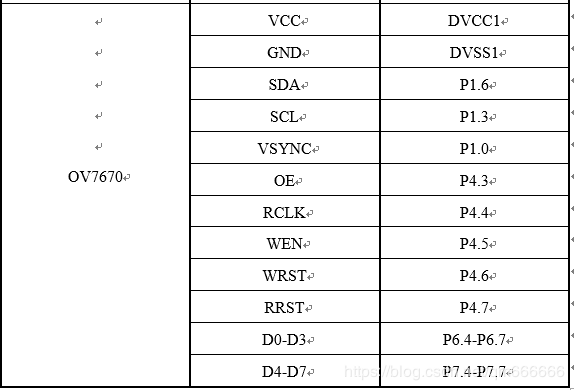

管脚分配如图所示:
宏定义:
//SCL-P1.3,SDA-P1.6
#define SCCB_SIC_H()     P1OUT|=BIT3
#define SCCB_SIC_L()     P1OUT&=~BIT3
#define SCCB_SID_H()     P1OUT|=BIT6
#define SCCB_SID_L()     P1OUT&=~BIT6
#define SCCB_SID_IN      P1DIR &= ~BIT6
#define SCCB_SID_OUT     P1DIR |= BIT6
#define SCCB_SID_STATE P1IN&BIT6
#define OE_L    P4OUT &= ~BIT3
#define OE_H    P4OUT |= BIT3
#define RCLK_L  P4OUT &= ~BIT4
#define RCLK_H  P4OUT |= BIT4
#define WEN_L   P4OUT &= ~BIT5
#define WEN_H   P4OUT |= BIT5
#define WRST_L  P4OUT &= ~BIT6
#define WRST_H  P4OUT |= BIT6
#define RRST_L  P4OUT &= ~BIT7
#define RRST_H  P4OUT |= BIT7
//像素存储
#define piexl_w 320
#define piexl_h 240
