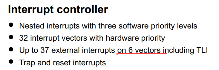

STM8的外部中断和STM32不一样,每个端口PX只有1个中断

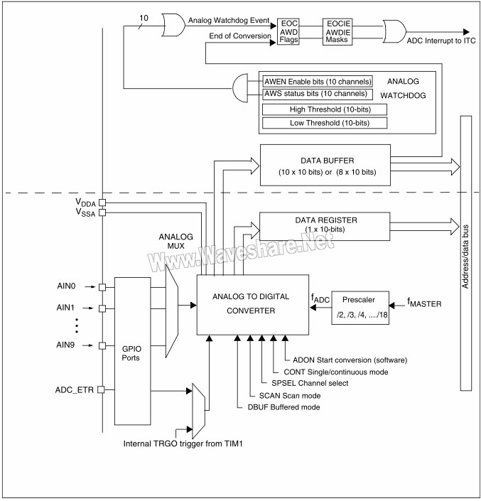

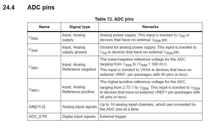

 2、ADC
1)Additional AIN12 analog input is not selectable in ADC scan mode or with analog watchdog. Values converted from AIN12 are stored only into the ADC_DRH/ADC_DRL
registers
2)关于引脚ADC_ETR的接法

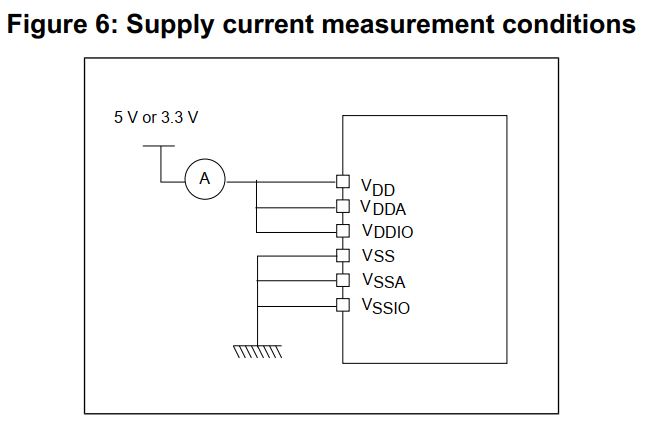

 3、电源
