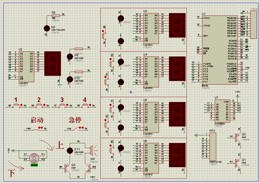

单片机源程序:
#include
#define u8 unsigned char
unsigned char seg_table[]={0x3f,0x06,0x5b,0x4f,0x66,0x6d,0x7d,0x07,0x7f,0x6f,0x00};
unsigned char run,floor;
bit ud,stop=0;
sbit P06=P0^6;
sbit P07=P0^7;
sbit ulc=P2^0;
sbit dlc=P2^1;
sbit start=P2^2;
sbit alrl=P2^3;
sbit alrb=P2^4;
void input()
        run|=((~P0)&0x3f);
        if((P06==0)&&(ud==1))
        run|=0x02;
        if((P06==0)&&(ud==0))
        run|=0x04;
        if((P07==0)&&(ud==1))
        run|=0x08;
        if((P07==0)&&(ud==0))
        run|=0x10;
void delay(int j)
  int i;
  for(;j>0;j--)
        input();
        for(i=200;i>0;i--)
          if(stop==1)
          break;
        if(stop==1)
        break;
void StepMotor(bit a,u8 b)
  u8 x=0x80,i;
  if(a==1)
        ulc=0;
        dlc=1;
    for(i=0;i        {
          if(x==0x10)
            x=0x80;
          else
            x=x/2;
          P3|=(x&0xf0);
          delay(100);
  else
         ulc=1;
         dlc=0;
     for(i=0;i        {
          if(x==0x80)
            x=0x10;
          else
            x=x*2;
          P3|=(x&0xf0);
          delay(100);
void alarm()
  alrl=0;
  while(1)
    alrb = ~alrb;
        delay(200);
void main()
        floor=1;
        P1=seg_table[floor];
        P0=0xff;
        ud=1;
        run=0;
        ulc=1;
        dlc=1;
        alrl=1;
    alrb=1;
        TCON=0x01; //打开外部中断0,并设置为下降沿触发
        IE=0x81;   //开总中断
        while(1)
             while(start==1)
                  P1=seg_table[10];
                  ulc=1;
          dlc=1;
                input();
                switch(floor)
                  case 1:                                  //1
                        if((run&0x01)==0x01)
                          delay(600);
                          run&=0xfe;
                    if((run&0x3e)!=0)
                          StepMotor(1,5);
                          floor=2;
                          ud=1;
                        else
                          ulc=1;
              dlc=1;
                  }         break;
                  case 2:
                    if(ud==1)                                 //2上
                          if((run&0x02)==0x02)
                            delay(600);
                            run&=0xfd;
                      if((run&0x38)!=0)
                            StepMotor(1,5);
                            floor=3;
                          else
                            ud=0;
                                ulc=1;
                dlc=1;
                        else                                            //2下
                          if((run&0x04)==0x04)
                            delay(600);
                            run&=0xfb;
                      if((run&0x01)!=0)
                            StepMotor(0,5);
                            floor=1;
                          else
                            ud=1;
