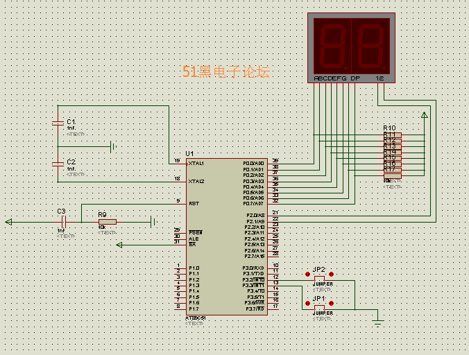

2020年10月28日 | 从99显示到0的动态显示(单片机设计)
2020-10-28 来源:51hei
单片机源程序如下:
#include
#define uint unsigned int
#define uchar unsigned char
uchar code table[]={0xc0,0xf9,0xa4, 0xb0,0x99,0x92,0x82,0xf8,0x80,0x90};
sbit gw=P2^1;
sbit sw=P2^0;
sbit w2=P1^0;
uchar WeiLujun,WeiLujun1=100,WeiLujun2,s,g;
void Init()
        TMOD=0X01;
        TH0=(65536-50000)/256;
        TL0=(65536-50000)%256;
        EA=1;
        ET0=1;
        TR0=1;
void delay(uint xms)
        uint i,j;
        for(i=xms;i>0;i--)
        for(j=110;j>0;j--);
void scankey()
        if(w2==0)
                delay(5);
                if(w2==0)
                       WeiLujun2++;
                        while(!w2);
                        if(WeiLujun2==1)
                           TR0=0;
                        if(WeiLujun2==2)
                                  TR0=1;
void main()
        Init();
        while(1)
                scankey();
                gw=1;
                P0=table[g];
                delay(1);
                gw=0;
                delay(1);
                sw=1;
                P0=table[s];
                delay(1);
                sw=0;
                delay(1);
void Timer0()interrupt 1
