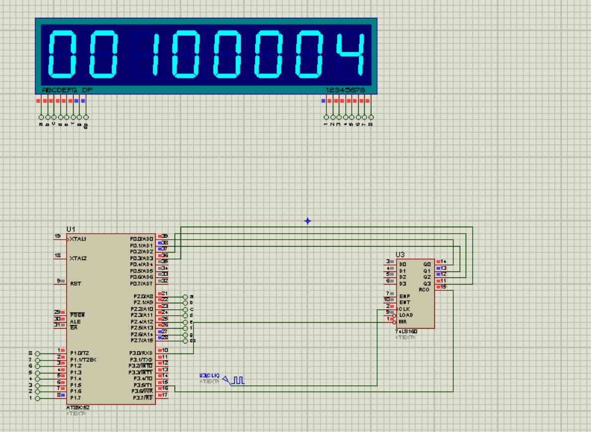

因为51单片机晶振的原因,测频的范围有限制,这时就需要外置74LS160分频器,进行分频。
本程序采用了定时器的方式2定时,8位自动重装计数器,精准定时。
单片机源程序:
#include
#include
#define Duan P2
#define Wei P1
sbit mr = P3^0;
unsigned char code smg_duan[] ={0x3f,0x06,0x5b,0x4f,0x66,0x6d,0x7d,0x07,0x7f,0x6f};
unsigned char code smg_wei[] ={0xfe,0xfd,0xfb,0xf7,0xef,0xdf,0xbf,0x7f};
unsigned int Num;
long int pin;
long int count;
void delay_ms(int i)
        int j;
        for(i;i>0;i--)
                for(j=100;j>0;j--);
void display(long int num)
        long num1[8],i;
        num1[7] = num/10000000;
        num1[6] = (num/1000000)%10;
        num1[5] = (num/100000)%10;
        num1[4] = (num/10000)%10;
        num1[3] = (num/1000)%10;
        num1[2] = (num/100)%10;
        num1[1] = (num/10)%10;
        num1[0] = num%10;
        for(i=0;i<8;i++){
        Wei = smg_wei[i];
        Duan = smg_duan[num1[i]];
        delay_ms(1);
void main()
        TMOD = 0x72;
        TH0 = 0x06;
        TL0 = 0x06;
        TH1 = 0x00;
        TL1 = 0x00;
        ET1 = 1;
        ET0 = 1;
        EA = 1;
        //PT1=1;
        TCON = 0x50;
        while(1)
                display(pin);
void timer0() interrupt 1   //定时器
                unsigned char a;
                if(Num==3999)
                TCON = 0x00;
                EA=0;
                Num = 0;
                a=P0&0x0f;               //分频器读数
                pin = (256*count+TL1)*10+a;    //溢出的次数*256+还未溢出的次数+分频器的计数
                TH1 = 0x00;
                TL1 = 0x00;
                TL0 = 0x06;
                TH0 = 0x06;
                count = 0;
                mr=0;
                _nop_();
                EA=1;
                TCON = 0x50;
                mr=1;
                else Num++;
                //display(pin);
void timer1() interrupt 3    //计数器
        count++;    中断溢出的次数
