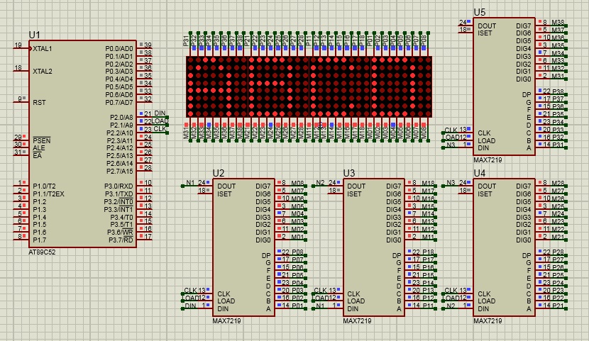

2020年12月23日 | MAX7219多片级联驱动点阵单片机程序编写经历
2020-12-23 来源:51hei
main.c
#include
#include "intrins.h"
#include "Max7219.h"
uchar code laji[][8]={
{0x18,0x24,0x42,0x42,0x7E,0x42,0x42,0x42},//A
{0x7C,0x42,0x42,0x7C,0x42,0x42,0x42,0x7C},//B
{0x3C,0x42,0x40,0x40,0x40,0x40,0x42,0x7C},//C
{0x7C,0x42,0x42,0x42,0x42,0x42,0x42,0x7C},//D
/*n毫秒的延时程序*/
/*void Delay_xms(uint x)
  uint i,j;
  for(i=0;i  for(j=0;j<112;j++);
void main()
  uchar i,j;
  //Delay_xms(50);
  MAX7219Init();
  while(1)
                for(j=0;j<8;j++)
      for(i=0;i      {
        Max7219WR(j+1,laji[i][j]);
      CS=1; _nop_(); CS=0;
                        //Delay_xms(100);
Max7219.h
#ifndef _Max7219_H_
#define _Max7219_H_
#define uchar unsigned char
#define uint  unsigned int
#define number  4 //点阵级联个数
#define lum     5 //亮度级别,0-F,共16级
//定义Max7219端口
sbit CLK = P2^2;  //时钟 Max7219_pin
sbit CS  = P2^1;  //锁存
sbit DIN = P2^0;  //数据
//向MAX7219 写入地址和数据
void Max7219WR(uchar addr,uchar dat)
  uchar n=8;
        CLK=0;
        CS=0;   //CS=0有效,CS=1锁存
        /*发送数据 高位先发*/
        while(n--)
          DIN = addr & 0x80;
                CLK=1;
                addr <<= 1;
                CLK=0;
        n=8;
        /*发送数据 高位先发*/
        while(n--)
          DIN = dat & 0x80;
                CLK=1;
                dat <<= 1;
                CLK=0;
void MAX7219Init()
  uchar i,j;
        for(i=0;i<5;i++)  //
          for(j=number;j>0;j--)
                switch(i)
                  case 0:Max7219WR(0x09, 0x00); break; //译码方式:BCD码 不译码
                        case 1:Max7219WR(0x0A, lum);  break; //亮度 0-15 共16级
                        case 2:Max7219WR(0x0B, 0x07); break; //扫描界限;8位显示
                        case 3:Max7219WR(0x0C, 0x01); break; //掉电模式:0,普通模式:1
                        case 4:Max7219WR(0x0F, 0x00); break; //显示测试:1;测试结束,正常显示:0
                CS=1; _nop_(); CS=0; //每写入四次给一个锁存脉冲
#endif
