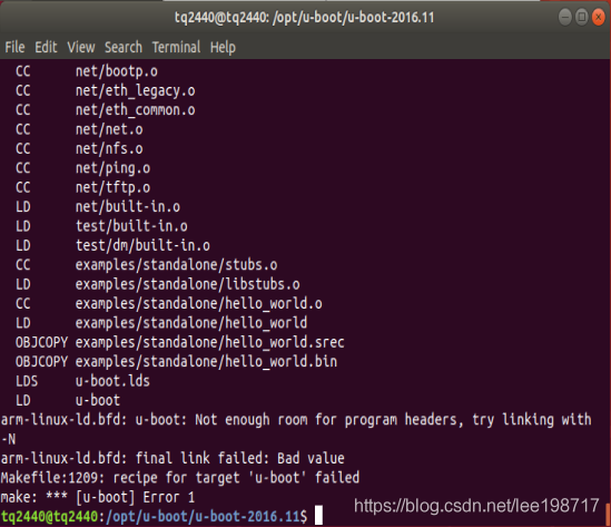

  1. 测试编译环境
(1)清理环境并重新编译
make distclean
make tq2440_defconfig
make
编译失败,并提示” Not enough room for program headers, try linking with -N”错误:
错误信息:
arm-linux-ld.bfd: u-boot: Not enough room for program headers, try linking with -N
arm-linux-ld.bfd: final link failed: Bad value
Makefile:1209: recipe for target 'u-boot' failed
make: *** [u-boot] Error 1
(2)根据网上资料,修改顶层配置文件:
gedit Makefile
找到:
LDFLAGS_u-boot += $(LDFLAGS_FINAL)
在下面插入:
# Avoid 'Not enough room for program headers' error on binutils 2.28 onwards
LDFLAGS_u-boot += $(call ld-option, --no-dynamic-linker)

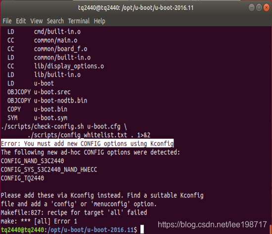

(3)重新编译
make
在根目录下生成了u-boot.bin文件,但提示“Error: You must add new CONFIG options using Kconfig”错误
错误信息:
The following new ad-hoc CONFIG options were detected:
CONFIG_NAND_S3C2440
CONFIG_SYS_S3C2440_NAND_HWECC
CONFIG_TQ2440
Please add these via Kconfig instead. Find a suitable Kconfig
file and add a 'config' or 'menuconfig' option.
Makefile:827: recipe for target 'all' failed
make: *** [all] Error 1
这一个错误产生的原因是修改了配置头文件中的默认宏定义而导致配置检查无法通过,如果根据消息提示手工在whitelist.txt文件中添加相应宏,由于不知道whitelist.txt文件中的排序规则,仍旧可能报错。
(4)解决白名单校验不通过问题
根据网上资料来看,目前切实有效的解决办法是关闭该校验功能。
gedit Makefile
找到:
       $(srctree)/scripts/check-config.sh u-boot.cfg
              $(srctree)/scripts/config_whitelist.txt ${srctree} 1>&2
在开头位置使用#屏蔽这两行:
#     $(srctree)/scripts/check-config.sh u-boot.cfg
#            $(srctree)/scripts/config_whitelist.txt ${srctree} 1>&2

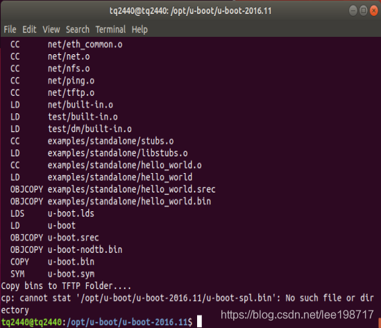

  1. 创建自动编译批处理脚本
(1)编写自动编译脚本
gedit auto_build.sh
添加如下内容:
#!/bin/bash
echo "Clean Configuration File..."
make distclean
echo "Clean Obj..."
make clean
echo "Load Configuration File..."
echo "make..."
make CROSS_COMPILE=arm-linux-
echo "Copy bins to TFTP Folder...."
cp /opt/u-boot/u-boot-2016.11/u-boot.bin /opt/TFTP/u-boot.bin
cp /opt/u-boot/u-boot-2016.11/spl/u-boot-spl.bin /opt/TFTP/u-boot-spl.bin
(2)为自动编译脚本文件添加执行权限
sudo chmod +X auto_build.sh
(3)修改自动编译脚本文件所有者
sudo chown -R tq2440:root /opt/u-boot/u-boot-2016.11/auto_build.sh
(4)执行自动编译脚本
bash ./auto_build.sh
编译成功:
  1. 小结
