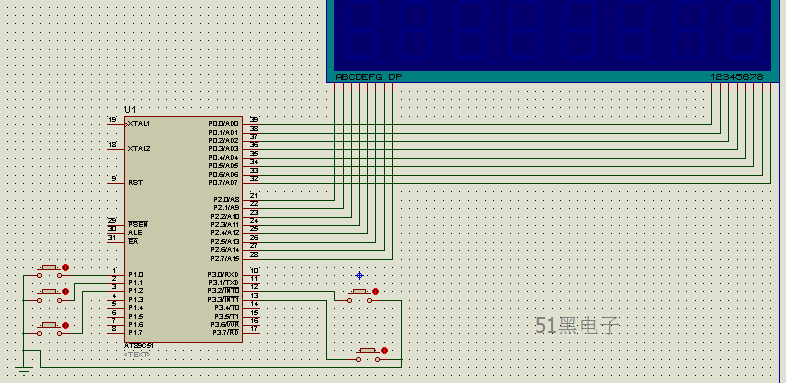

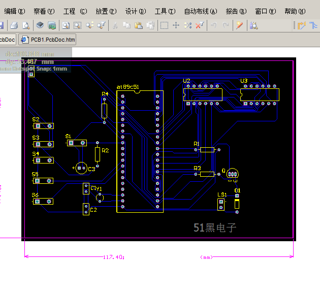

2021年01月05日 | 基于51单片机的数字时钟
2021-01-05 来源:51hei
#include
#define uchar unsigned char
#define uint unsigned int
sbit qingling=P1^0;
sbit tiaofen=P1^1;
sbit tiaoshi=P1^2;
sbit sounder=P1^3;
uint a,b;
uchar hour,minu,sec,
      hour0,minu0,sec0,
          hour1,minu1,sec1;
          h1,h2,m1,m2,s1,s2,
          k,s;
uchar code select[]={0x7f,0xbf,0xdf,0xef,0xf7,0xfb,0xfd,0xfe};
uchar code table[]=        {0x3f,0x06,0x5b,0x4f,0x66,0x6d,0x7d,0x07,0x7f,0x6f};
void keyscan();
void init();
void delay(int z);
void display(uchar,uchar,uchar);
void sounde();
void main()
        init();
        while(1)
                while(TR1)
                        keyscan();
                        while(s==1)
                                keyscan();
                                display(hour1,minu1,sec1);
                         display(hour0,minu0,sec0);
                        while(k)
                                 display(hour,minu,sec);
void init()
        a=0;
        b=0;
        k=0;
        s=0;
        hour0=0;
        minu0=0;
        sec0=0;
        hour=0;
        minu=0;
        sec=0;
        hour1=0;
        minu1=0;
        sec1=0;
        TMOD=0x11;
        TH0=(65536-5000)/256;
        TL0=(65536-5000)%256;
        TH1=(65536-50000)/256;
        TL1=(65536-50000)%256;
        EA=1;
        EX0=1;
        EX1=1;
        ET0=1;
        ET1=1;
        IT0=1;
        IT1=1;
        PX0=1;
        PX1=1;
        TR0=0;
        TR1=1;
void timer0_int() interrupt 1
        a++;
        if(a==2)
                a=0;
                sec++;
                if(sec==100)
                                sec=0;
                                minu++;
                                if(minu==60)
                                        minu=0;
                                        hour++;
                                        if(hour==60)
                                                hour=0;
void ex0_int() interrupt 0
        k++;
        if(k==3)
        k=0;
        if(k==1)
                TR0=~TR0;
                if(TR0==1)
                        hour=0;
                        minu=0;
                        sec=0;
        if(k==2)
                TR0=~TR0;
void ex1_int() interrupt 2
        s++;
        if(s==3)
        s=0;
void timer1_int() interrupt 3
        if(s==2)
                if(hour1==hour0 && minu0==minu1)
                sounde();
        b++;
        if(b==20)
                b=0;
                sec0++;
         if(sec0==60)
              sec0=0;
                minu0++;
              if(minu0==60)
                   minu0=0;
                   hour0++;
                   if(hour0==24)
                         hour0=0;
