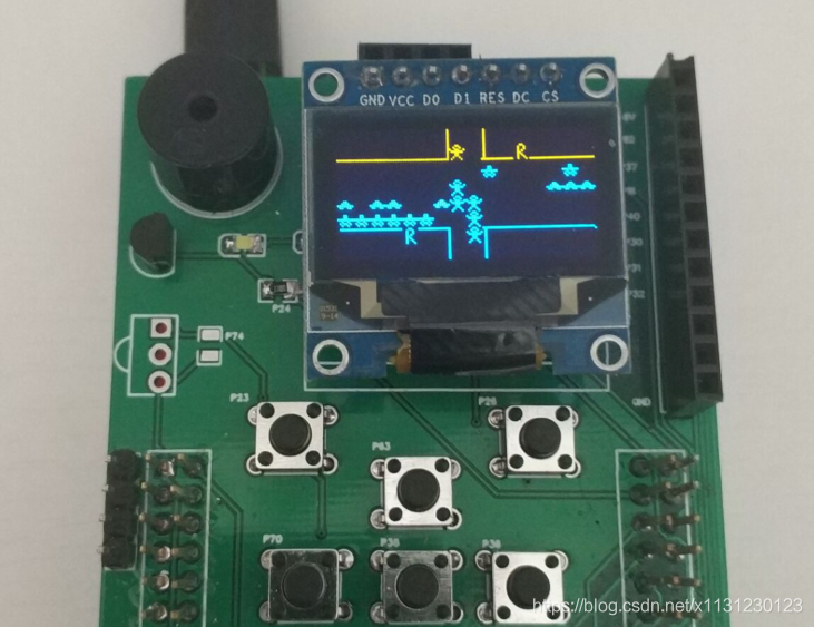

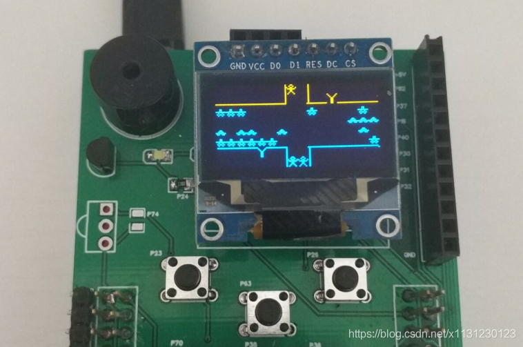

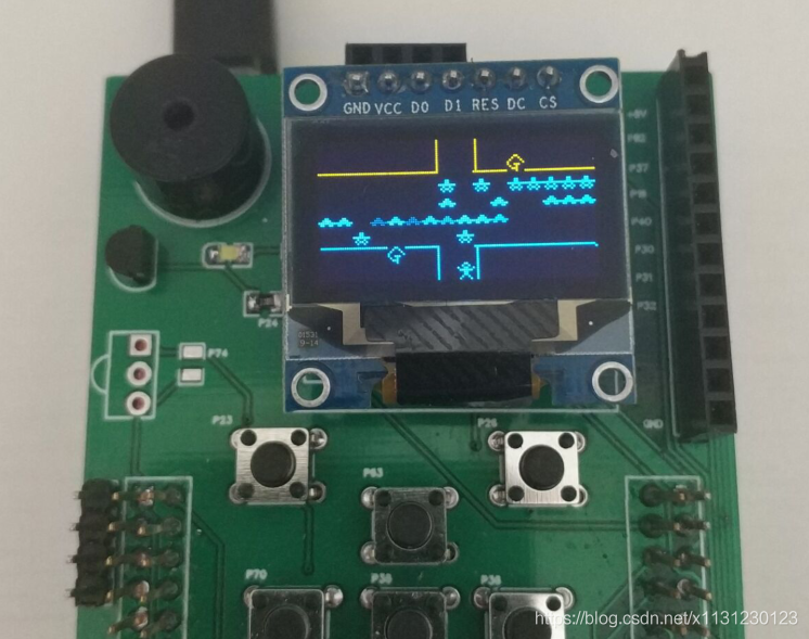

Traffic light simulator. Draw a traffic intersection on the OLED display. Have cars, pedestrians, and
bicycles randomly move across the display. When the cars approach the intersection, display the traffic
light signals in 2 directions. If a pedestrian wants to cross the street, change the stoplight and have the
cars stop.
O
LED 接线
//OLED----MSP430
//VCC-----3.3V
//GND-----GND
//D0------P3.2
//D1------P3.0
//RES-----P2.0
//DC------P2.2
//CS------P8.1
随机生成车辆和人物,动画播放效果。
在这里插入图片描述
在这里插入图片描述
在这里插入图片描述
