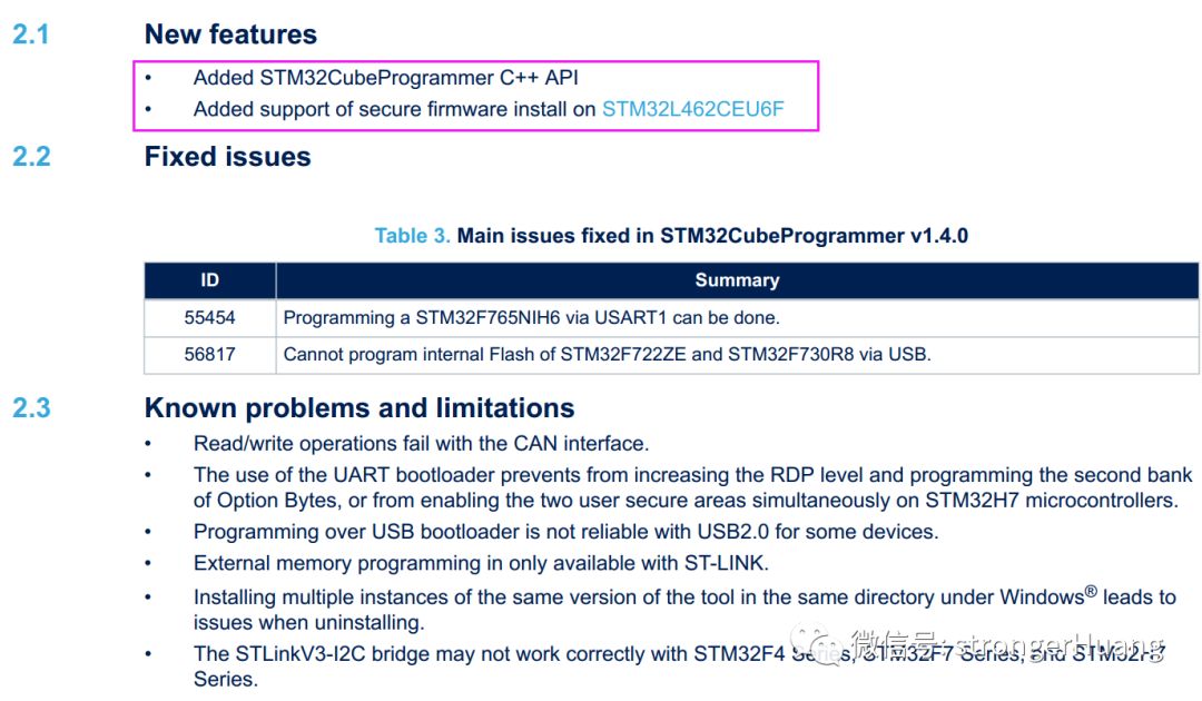

就在这前不久STM32CubeProgrammer升级到V1.4.0版本了。主要更新内容:
这里新增两条内容:
  • Added STM32CubeProgrammer C++ API
  • Added support of secure firmware install on STM32L462CEU6F
第2条估计都还好理解,第1条是什么意思呢?
安装好STM32CubeProgrammer-1.4.0之后,在安装目录下有关于api相关的说明文档STM32CubeProgrammer_API.chm:
In addition to the graphical user interface and the commandline interface, STM32CubeProgrammer offers a C++ API that you could use to develop your own application and benefit of wide range of features to program STM32 microcontrollers memories (such as Flash, RAM, and OTP) either over debug interface or bootloder interface (USB DFU, UART, I²C, SPI and CAN).
大概意思就是:除了使用STM32CubeProgrammer这套界面和命令行工具编程之外,还提供这套API接口对STM32的FLASH、RAM和OTP编程,基于USB DFU, UART, I²C, SPI and CAN的bootloder。(主要作用还是Progrom)
