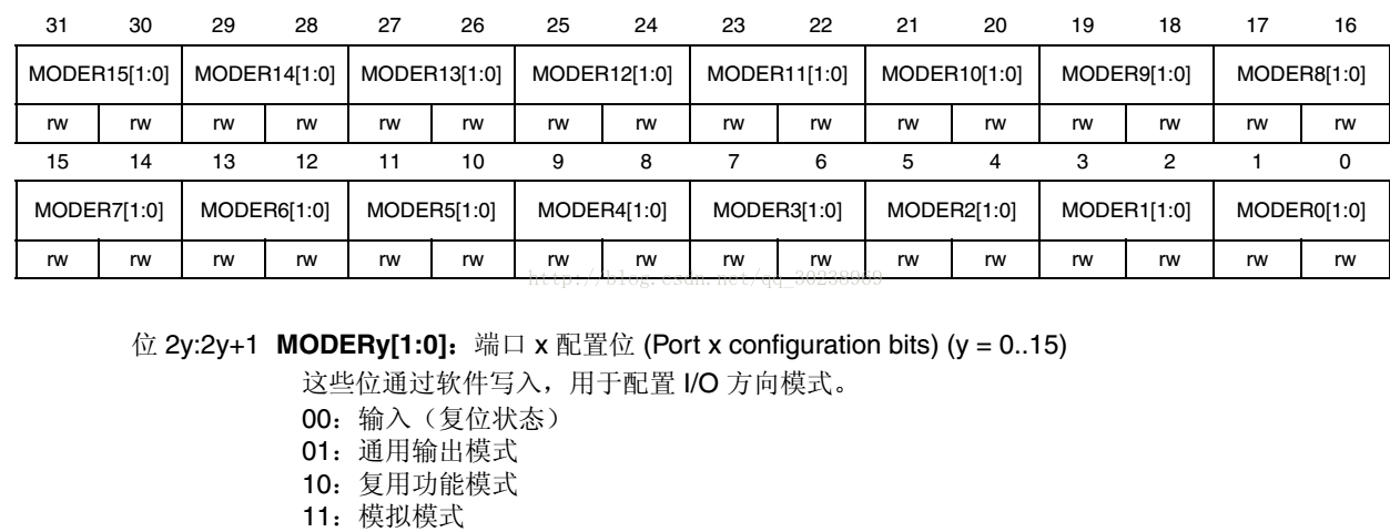

从上文可以看到,在系统启动过程中会对系统时钟进行一次配置,有了时钟源以后,我们来看简单的GPIO配置:对于GPIO,使用寄存器进行配置时:我们先来看一个例子:
#include
uint32_t Gb_TimingDelay;
void Delay(uint32_t nTime);
void main()
  SysTick_Config(SystemCoreClock/1000);//1ms based time
  RCC->AHB1ENR |= RCC_AHB1ENR_GPIODEN;  //ENABLE GPIOD
  RCC->APB2ENR |= RCC_APB2ENR_SYSCFGEN; //ENABLE SYSCFG
  GPIOD->MODER &= 0x00FFFFFF;      //set direction
  GPIOD->MODER |= 0x55000000;

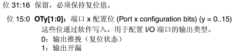

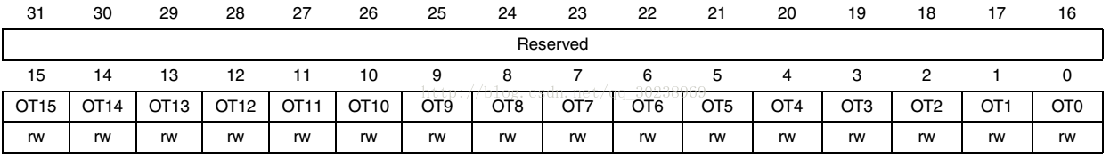

  GPIOD->OTYPER &= 0xFFFF0FFF;    //set the way of output:31-16:observed 15-0: 1: output push-pull 0: output open-drain

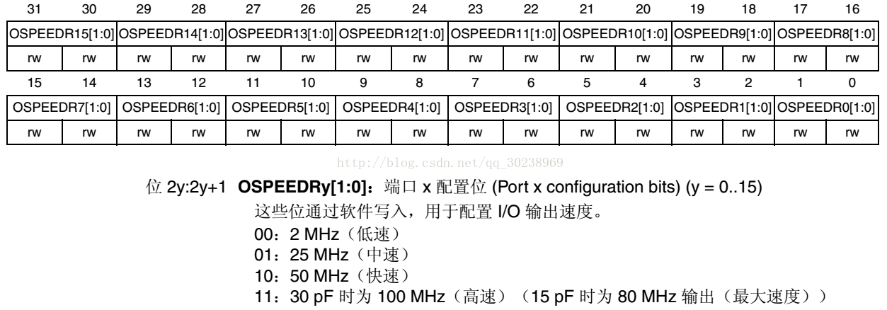

  GPIOD->OSPEEDR &= 0X00FFFFFF;  //speed
  GPIOD->OSPEEDR |= 0XFF000000;
  SYSCFG->CMPCR =0X00000001;    //speed CMR

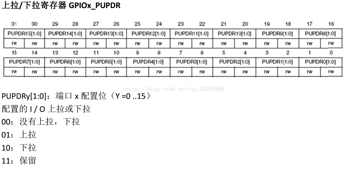

  GPIOD->PUPDR= 0X00FFFFFF;   //pull-up or pull-down

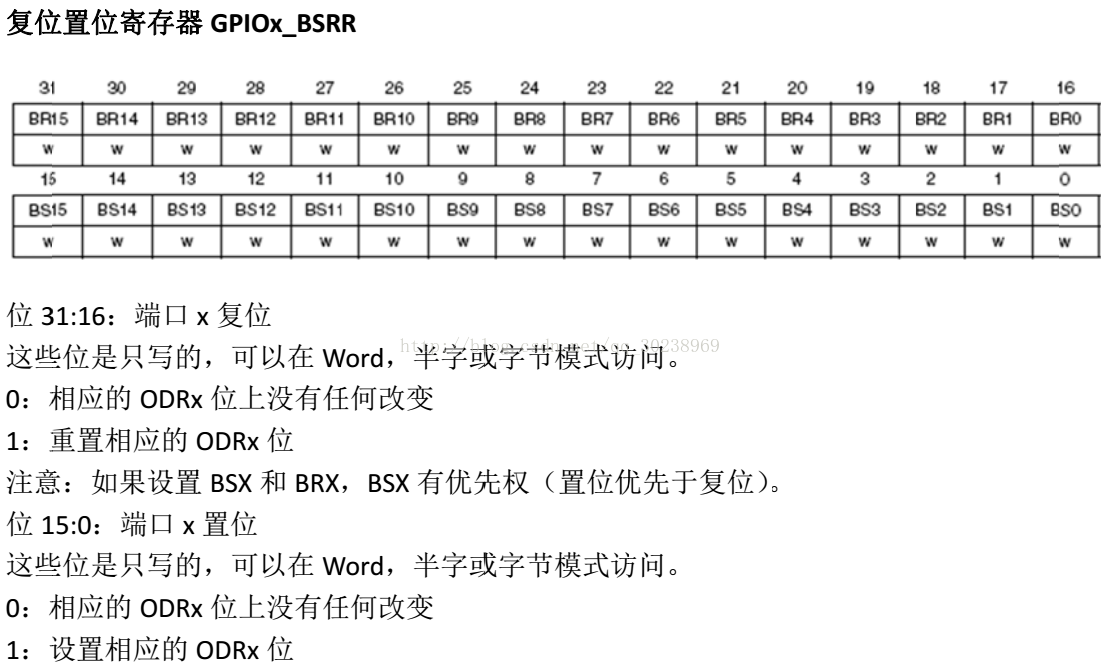

  GPIOD->BSRRH= 0XF000;       //clear or set
  while(1)
    GPIOD->BSRRH = 0XF000;
    GPIOD->BSRRL = 0X1000;
    Delay(100);
    GPIOD->BSRRL = 0X1000<<1;
    Delay(100);
    GPIOD->BSRRL = 0X1000<<2;
    Delay(100);
    GPIOD->BSRRL = 0X1000<<3;
    Delay(100);

我们重点看GPIO寄存器·:
1.GPIO端口模式寄存器GPIOx_MODER
2.GPIO端口输出类型寄存器GPIOx_OTYPER
3.GPIO端口输出速度控制器GPIOx_OSPEEDR
4.GPIO端口上拉下拉寄存器GPIOx_PUPDR
5.GPIO端口置位复位寄存器GPIOx_BSRR
