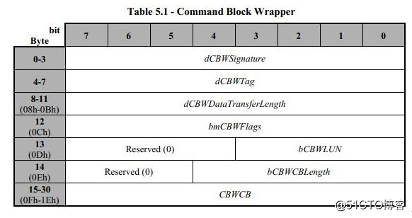

类请求完成后,就进入了数据传输过程,在仅批量数据传输协议中规定,数据传输分为三个阶段:命令阶段、数据阶段和状态阶段。命令阶段是由主机通过批量端点发送一个CBW(命令封装包)的结构,在CBW中定义了要操作的命令以及传输数据的方向和数量,数据阶段的传输方向由命令阶段决定,而状态阶段则总是由设备返回该命令完成的状态。
CBW的结构如下图
官方文档对这些字段的介绍:
dCBWSignature:
Signature that helps identify this data packet as a CBW. The signature field shall contain the value
43425355h (little endian), indicating a CBW.
dCBWTag:
A Command Block Tag sent by the host. The device shall echo the contents of this field back to the
host in the dCSWTag field of the associated CSW. The dCSWTag positively associates a CSW with the corresponding CBW.
dCBWDataTransferLength:
The number of bytes of data that the host expects to transfer on the Bulk-In or Bulk-Out endpoint (as indicated by the Direction bit) during the execution of this command. If this field is zero, the device and the host shall transfer no data between the CBW and the associated CSW, and the device shall ignore
bmCBWFlags:
The bits of this field are defined as follows:
Bit 7 Direction - the device shall ignore this bit if the dCBWDataTransferLength field is
zero, otherwise:
0 = Data-Out from host to the device,
1 = Data-In from the device to the host.
Bit 6 Obsolete. The host shall set this bit to zero.
Bits 5..0 Reserved - the host shall set these bits to zero.
bCBWLUN:
The device Logical Unit Number (LUN) to which the command block is being sent. For devices that
support multiple LUNs, the host shall place into this field the LUN to which this command block is
addressed. Otherwise, the host shall set this field to zero.
bCBWCBLength:
The valid length of the CBWCB in bytes. This defines the valid length of the command block. The
only legal values are 1 through 16 (01h through 10h). All other values are reserved.
CBWCB:
The command block to be executed by the device. The device shall interpret the first bCBWCBLength
bytes in this field as a command block as defined by the command set identified by bInterfaceSubClass .
If the command set supported by the device uses command blocks of fewer than 16 (10h) bytes in
length, the significant bytes shall be transferred first, beginning with the byte at offset 15 (Fh). The
device shall ignore the content of the CBWCB field past the byte at offset (15 + bCBWCBLength - 1).
