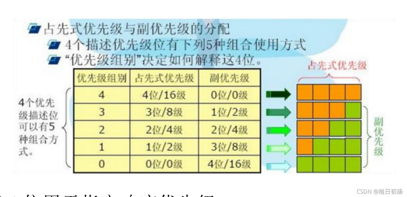

一、中断优先级分组
NVIC_PriorityGroupConfig(NVIC_PriorityGroup_1);
#define NVIC_PriorityGroup_0         ((uint32_t)0x700) /*!< 0 bits for pre-emption priority
                                                            4 bits for subpriority */
#define NVIC_PriorityGroup_1         ((uint32_t)0x600) /*!< 1 bits for pre-emption priority
                                                            3 bits for subpriority */
#define NVIC_PriorityGroup_2         ((uint32_t)0x500) /*!< 2 bits for pre-emption priority
                                                            2 bits for subpriority */
#define NVIC_PriorityGroup_3         ((uint32_t)0x400) /*!< 3 bits for pre-emption priority
                                                            1 bits for subpriority */
#define NVIC_PriorityGroup_4         ((uint32_t)0x300) /*!< 4 bits for pre-emption priority
                                                            0 bits for subpriority */
二、概念
1. 组0就是4位都用来设置成响应优先级,2^4=16位都是响应优先级。
2. 组1分为(2^1)两个抢占优先级,在这两个抢占优先级里面还分别有(2^3)八个响应优先级,(2^1) * (2^3) =16
3. 组1分为(2^2)四个抢占优先级,在这四个抢占优先级里面还分别有(2^2)四个响应优先级,(2^2) * (2^2) =16
4. 组1分为(2^3)八个抢占优先级,在这八个抢占优先级里面还分别有(2^1)两个响应优先级,(2^3) * (2^1) =16
5. 组1分为(2^4)十六个都是抢占优先级  (2^4) =16
