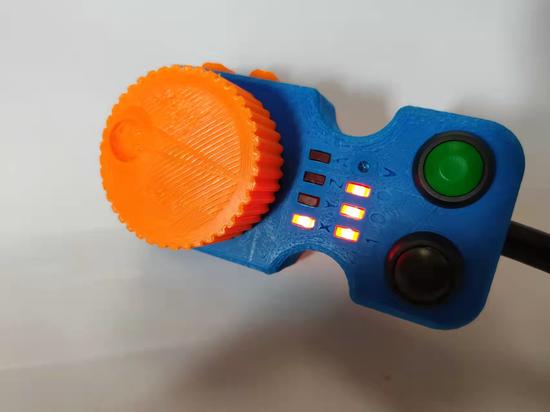

stm8S103 手轮DIY 代码如下:
#include "IOSTM8S103F3.h"
#define u8 uint8_t
#define u16 uint16_t
#define u32 uint32_t
#define LED10  PA_ODR_ODR2
#define LED100 PA_ODR_ODR3
#define LEDX   PD_ODR_ODR4
#define LEDY   PD_ODR_ODR5
#define LEDZ   PD_ODR_ODR6
#define LEDA   PA_ODR_ODR1
#define KZ10  PD_ODR_ODR2
#define KZ100 PD_ODR_ODR3
#define KZX   PC_ODR_ODR4
#define KZY   PC_ODR_ODR5
#define KZZ   PC_ODR_ODR6
#define KZA   PC_ODR_ODR7
typedef unsigned char uint8_t;
typedef unsigned short uint16_t;
typedef unsigned long uint32_t;
u8 XYZA=0;
void Delayms(unsigned int ms)
   u8 i,y;
   while(ms != 0)
       for(y=0;y<100;y++)
       for(i=0;i<200;i++)
    ms--;
//****************io口初始化****************/
void GPIO_INIT()
PA_DDR = 0xFF;//
PA_CR1 = 0xFF;
PA_CR2 = 0xFF;
PA_ODR = 0xFF;
PB_DDR = 0x00;//按钮
PB_CR1 = 0x00;
PB_CR2 = 0xFF;
EXTI_CR1=0xAA;
PC_DDR = 0xFF;//
PC_CR1 = 0xFF;
PC_CR2 = 0xFF;
PC_ODR = 0xFF;
PD_DDR = 0xFF;//
PD_CR1 = 0xFF;
PD_CR2 = 0xFF;
PD_ODR = 0xFF;
//*********************************主函数************************************/
main()
  //Delayms(50);//稳定
  CLK_CKDIVR=0x00; //时钟不分频 16M
  Delayms(100);//稳定
  GPIO_INIT();
  KZX=0;
  LEDX=0;
  asm("rim");
  while (1)
//PB中断服务函数
#pragma vector=0x06 //PB 中断响应
__interrupt void EXTI_PORTB_IRQHandler(void) //PB 服务函数
  if((PB_IDR&0x20)==0)
    Delayms(100);// 消按钮抖动
      if(LED10==1&&LED100==1) //10倍
        LED10=0;
        KZ10=0;
        KZ100=1;
      else
        if(LED10==0&&LED100==1)//100倍
        LED10=0;
        LED100=0;
        KZ10=1;
        KZ100=0;
        else
          if(LED10==0&&LED100==0)//1倍
            LED10=1;
            LED100=1;
            KZ10=1;
            KZ100=1;
  while((PB_IDR&0x20)==0x20);//释放按钮
  if((PB_IDR&0x10)==0)//4选1
     if(XYZA==0)
      LEDX=0;
      LEDY=1;
      LEDZ=1;
      LEDA=1;
      KZX=0;
      KZY=1;
      KZZ=1;
      KZA=1;
     if(XYZA==1)
      LEDX=1;
      LEDY=0;
      LEDZ=1;
      LEDA=1;
      KZX=1;
      KZY=0;
      KZZ=1;
      KZA=1;
     if(XYZA==2)
      LEDX=1;
      LEDY=1;
      LEDZ=0;
      LEDA=1;
      KZX=1;
      KZY=1;
      KZZ=0;
      KZA=1;
     if(XYZA==3)
      LEDX=1;
      LEDY=1;
      LEDZ=1;
      LEDA=0;
      KZX=1;
      KZY=1;
      KZZ=1;
      KZA=0;
      XYZA=0;
      else XYZA++;
     while((PB_IDR&0x10)==0x10);//释放按钮
