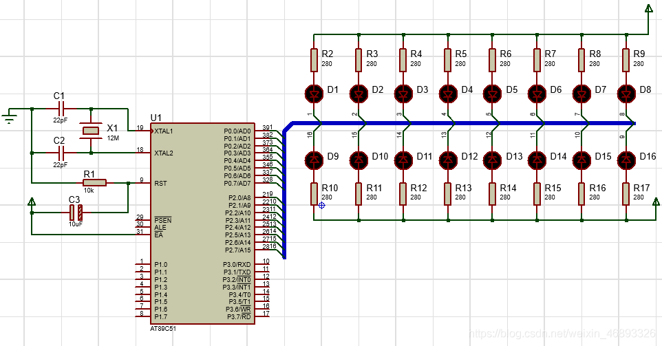

2021年12月10日 | 单片机TIMERO控制流水灯
2021-12-10 来源:eefocus
硬件连接:
代码:
#include
#include
#define uchar unsigned char
#define uint unsigned int
void main()
  uchar T_Count = 0;
P0 = 0xfe;
P2 = 0xfe;
TMOD = 0x01;
TH0  = (65535-40000)/256;
TL0  = (65535-40000)%256;
TR0  = 1;
while(1)
if(TF0 == 1)
TF0 = 0;
if(++T_Count == 100)
P0 = _crol_(P0,1);
P2 = _crol_(P2,1);
T_Count = 0;
