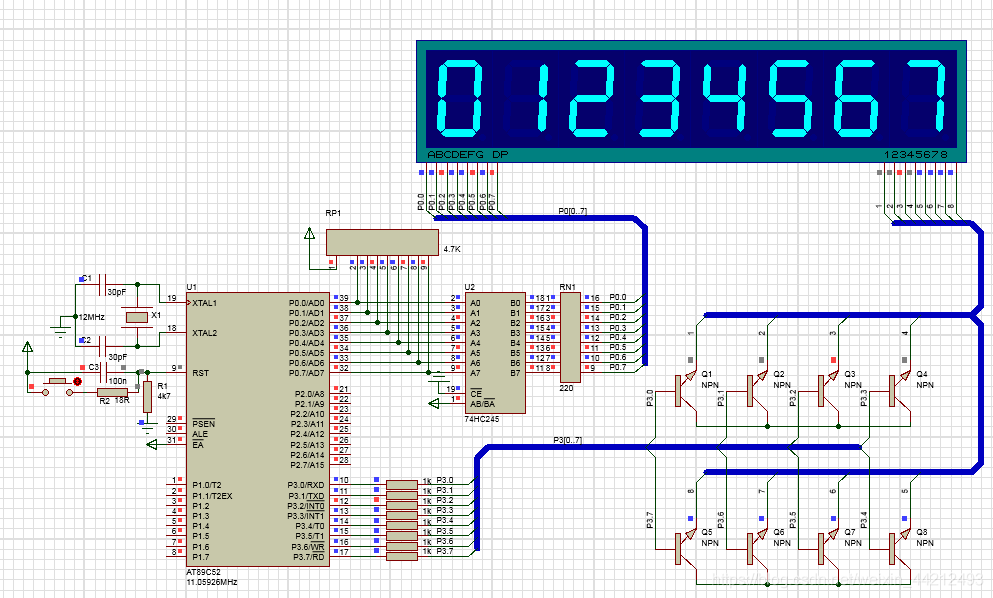

程序功能,从左到依次显示0,1,2,3,4,5,6,7 八个数字
程序源代码如下:
8只数码管同时显示不同字符
#include
typedef unsigned char uint8;
typedef unsigned int uint16;
code uint8 LED_CODE[] = {0xC0,0xF9,0xA4,0xB0,0x99,0x92,0x82,0xF8};
void delay(uint16 x)
uint16 i,j;
for(i = x; i > 0; i --)
for(j = 114; j > 0; j --);
void main()
uint8 i;
while(1)
for(i = 0; i < 8; i ++)
P0 = 0xFF;
P3 = 0x01 << i;
P0 = LED_CODE[i];
delay(4);
