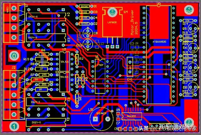

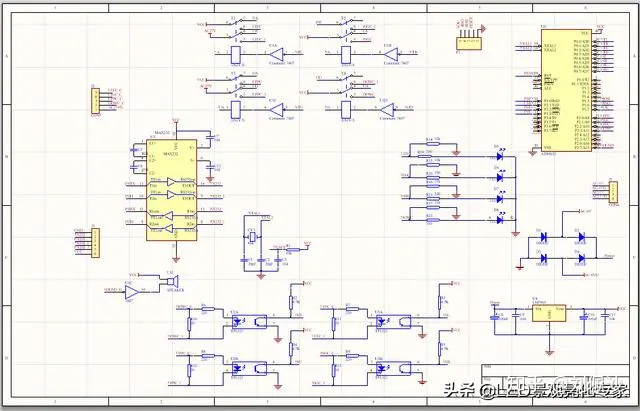

2022年12月27日 | 云台单片机控制源程序
2022-12-27 来源:zhihu
#include "AT89X52.H"
#include "math.h"
sbit NTL = P0^0;//继电器控制,输出
sbit NTR = P0^1;
sbit NTU = P0^2;
sbit NTD = P0^3;
sbit INL = P0^4;//云台运动状况的检测电,输入
sbit INR = P0^5;
sbit INU = P0^6;
sbit IND = P0^7;
sbit LEFC = P2^0;//继电器的通断检测,
sbit LEGC = P2^1;
sbit UPPC = P2^2;
sbit DOWC = P2^3;
sbit SOUND = P2^7;
int counter=0,TimerCnt1Ms=0,LastTime1Ms;
char b,c,d= 0;
char Flag = 0,sc[3];
void Delay(int DelayTimeInMs);
void sendchar();
void checkpinc(char c);
void checkpind(char d);
void show(void);
void judge(char Flag);
void main (void)
SCON = 0x52; /* 设置串行口控制寄存器SCON*/
TMOD = 0x21; /* */
TCON = 0x69; /* TCON */
TH1 = 0xf3; /* TH1 */
ET1=1;
EA=1;
b = 0x01;
while( b<0x10 )
{ P0=0xFF;
switch(b)
{case 0x01 :
P0|=0x0F;
NTL=0;
break;
case 0x02 :
P0|=0x0F;
NTR=0;
break;
case 0x04 :
P0|=0x0F;
NTU=0;
break;
case 0x08 :
P0|=0x0F;
NTD=0;
break;
default:
P0=0x0F;
break;
Delay(900);
b <<=1;
SOUND=1;//蜂鸣器响
P0|=0x0F;
for(;;)
show();
judge (Flag);
sendchar();
if (Flag!=0xff)
int DelayNum=0;
do
SOUND=~SOUND;
DelayNum++;
Delay(1);
while( DelayNum<3000);
else
Delay(500);
void show(void)
b = 0x01;
c = 0x80;
d = 0x10;
Flag=0x00;
while( b<0x10 )
{ switch(b)
{case 0x01 :
P0|=0x0F;
NTL=0;
break;
case 0x02 :
P0|=0x0F;
NTR=0;
break;
case 0x04 :
P0|=0x0F;
NTU=0;
break;
case 0x08 :
P0|=0x0F;
NTD=0;
break;
checkpinc(c);
if (counter>10)
checkpind(d);
b <<=1;
c >>=1;
d <<=1;
counter=0;
SOUND=1;
NTL=1;
NTR=1;
NTU=1;
NTD=1;
void Delay(int DelayTimeInMs) // Note:DelayTimeInMs<1000
int LastTime1Ms = TimerCnt1Ms;
while(abs(TimerCnt1Ms-LastTime1Ms){}
TimerCnt1Ms=0;
// Timer0 overflow IntNum=10
void timer1_ovf_isr(void) interrupt 3
unsigned char Second,Minute,Hour = 0;
TimerCnt1Ms++;
if( TimerCnt1Ms==1000 )//1秒
TimerCnt1Ms = 0;
Second++;
if( Second==60 )
Second = 0;
Minute++;
if( Minute==60 )
Minute = 0;
Hour++;
void sendchar()
char i;
sc[2]=0x0d;
if ((Flag&0x0f)>9)
sc[0]=65+(Flag&0x0f)-0x0a;
else
sc[0]=48+(Flag&0x0f);
if((Flag&0xf0)>0x90)
sc[1]=65+((Flag>>4)&0x0f)-0x0a;
else
sc[1]=48+((Flag&0xf0)>>4);
for (i=0;i<=2;i++)
SBUF=sc[i];
// while (!(USR & 0x40))
// USR|=0x40;
void checkpinc(char c) //C端口检测
int DelayNum=0;
Delay(30);
counter=0;
do
Delay(2);
DelayNum++;
// if (PINC&c==c)
counter++;
while( DelayNum<15);
if (counter>10)
Flag |=c;
void checkpind(char d) //D端口检测
int DelayNum=0;
counter=0;
do
Delay(2);
DelayNum++;
// if (d!=(PIND&d))
counter++;
while( DelayNum<30);
if (counter>5)
Flag |=(d>>4);
void judge (char Flag)
int j,m,n;
for (j=0;j<=2;j++)
if (Flag!=0xff)
m=((Flag||0x0f)>>4)||0xf0;
n=Flag||0xf0;
if ((m-n)<=0)
else
if ((((~n)||0xf3)==0xff)|((n||0xf3)==0xff))
else
P0=((~n)||0xf3);
Delay(200);
P0=0x8f;
if ((((~n)||0xfc)==0xff)|((n||0xfc)==0xff))
else
P0=((~n)||0xfc);
Delay(200);
P0=0x8f;
Delay(5);
show();
else j=3;
P0=0x8f;
电原理图
控制板
