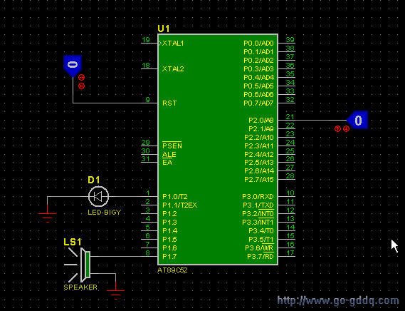

2018年01月22日 | 基于89C51的一个简单的警报系统
2018-01-22 来源:eefocus
#include "reg52.h"
#define   uchar unsigned char
#define   uint  unsigned int
sbit light = P1^0
sbit loud = P1^7;
sbit alarm = P2^0;
bit alarm_flag,flag_dec,flag_change;
uint t0_count = 1;
uint t0_set,second;
void delay_1ms(unsigned int count) //1MS的延时×count
 unsigned int i,j;
 for(i=0;i for(j=0;j<120;j++);
void light_show(int i)  //灯闪亮
 light = 0;
 delay_1ms(i);
 light = 1;
 delay_1ms(i);
void init_t0(void)   //初始化定时时钟
   TMOD=0x01; //方式2
   TH0=(65536-65436)/256;
   TL0=(65536-65436)%256;
   ET0=1;
   EA=0;
void init_IO(void)
 P1 = 0;
 P2 = 0;
void alarm_check(void)  //判断警报,为高电平打开警报
 if(alarm == 1)
  delay_1ms(10);
  if(alarm == 1);
   alarm_flag = 1; //响铃标志
   flag_change = 1; //铃声改变标志
   t0_set = 5; //调响铃节奏
void  alarm_close(void)   //低电平,解除警报
 if(alarm == 0)
  delay_1ms(10);
  if(alarm == 0);
   alarm_flag = 0;
   light = 0;
   loud = 0;
   TR0 = 0;
   EA = 0;
void main()
 uint i,j;
 init_t0();
 init_IO();
 while(1)
  alarm_check();
  while(alarm_flag)
   TR0 = 1;
   EA = 1;
   for(j = 0;j < 40;j++)
    alarm_close();
    if(alarm_flag == 0)
     break; //跳出循环
    light_show(100);
void t0(void) interrupt 1 using 0
 EA = 0;
 TR0 = 0;
 t0_count--;
 if(t0_count == 0)
  t0_count = t0_set;
  if(flag_change == 1)
   loud =  ~loud;
 if(flag_change == 0)
  loud = 1;
 second++;
 if(second == 30) //调时间长短
  flag_dec = 1;
  second = 0;
  if(t0_set ==1)
   t0_set = 1;
   flag_dec =0;
   flag_change = 0;
  if(flag_dec == 1)
   t0_set--;
 TR0 = 1;
 EA = 1;
