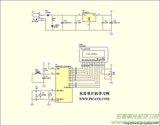

HT48R50A的 LCD显示示例程序
; Function :       LCD显示示例程序           *
; MICroProcessor : HT48R50A-1/28SKDIP-A      *
; Author:         www.picavr.com             *
; Crystal :       4MHz                       *
#INCLUDE                HT48R50A-1.INC
LCD_DATA        EQU     PA
LCD_DATA_CTRL   EQU     PAC
LCD_CTRL        EQU     PC
LCD_CTRL_CTRL   EQU     PCC
E               EQU     2

START:
        CLR     LCD_DATA
        CLR     LCD_DATA_CTRL
        CLR     LCD_CTRL
        CLR     LCD_CTRL_CTRL
        CALL    DELAY
        CLR     TBLP
         MOV      A,30H       ;\
         MOV      LCD_DATA,A  ;  > STEP 0
        CALL    WRITE       ;/   LCD RESET
        CALL    DELAY
         MOV      A,30H       ;\
        CALL    DELAY
         MOV      A,38H       ;\
         MOV      LCD_DATA,A  ;  > STEP 1
        CALL    WRITE       ;/   Function set
         MOV      A,06H       ;\
         MOV      LCD_DATA,A  ;  > STEP 2
        CALL    WRITE       ;/   Entry mode set
         MOV      A,01H       ;\
         MOV      LCD_DATA,A  ;  > STEP 3
        CALL    WRITE       ;/   Display clear
        CALL    DELAY
         MOV      A,0EH       ;\
         MOV      LCD_DATA,A  ;  > STEP 4
        CALL    WRITE       ;/   Display turn on/off
         MOV      A,83H       ;\
         MOV      LCD_DATA,A  ;  > STEP 5
        CALL    WRITE       ;/   DD RAM address set(First line)
