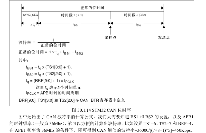

       CAN位时序寄存器(CAN_BTR)配置,设置其波特率,波特率计算如下图所示:
      CANx->MCR |= CAN_MCR_INRQ ;  (先进入初始化模式)
      CANx->MCR &= ~(uint32_t)CAN_MCR_TTCM;
      CANx->MCR |= CAN_MCR_ABOM;
     CANx->MCR &= ~(uint32_t)CAN_MCR_INRQ;(进入正常工作模式)

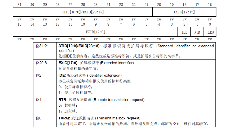

  4)CAN发送邮箱标识符寄存器CAN_TIxR
发送邮件时,先设置是标准还是扩展标识符,设置标识符,数据长度(发送邮箱长度和时间戳寄存器CAN_TDTxR),判断哪个邮箱为空,然后将TXRQ置1(发送完毕后,硬件自动置0),然后设置ID,将数据分别存入发送邮箱高字节与低字节邮箱,请求发送邮箱。
    TxMessage.ExtId=0x12;   //初始化设置
    TxMessage.IDE=0;
     TxMessage.RTR=0;
    TxMessage.DLC=len;
if ((CANx->TSR&CAN_TSR_TME0) == CAN_TSR_TME0)    //判断哪个邮箱为空
    transmit_mailbox = 0;
  else if ((CANx->TSR&CAN_TSR_TME1) == CAN_TSR_TME1)
    transmit_mailbox = 1;
  else if ((CANx->TSR&CAN_TSR_TME2) == CAN_TSR_TME2)
    transmit_mailbox = 2;
  else
    transmit_mailbox = CAN_TxStatus_NoMailBox;
    CANx->sTxMailBox[transmit_mailbox].TIR &= TMIDxR_TXRQ;     //请求发送邮箱
   if (TxMessage->IDE == CAN_Id_Standard)                                   //发送ID
      assert_param(IS_CAN_STDID(TxMessage->StdId));
      CANx->sTxMailBox[transmit_mailbox].TIR |= ((TxMessage->StdId << 21) | TxMessage->RTR);
    else
      assert_param(IS_CAN_EXTID(TxMessage->ExtId));
      CANx->sTxMailBox[transmit_mailbox].TIR |= ((TxMessage->ExtId << 3) | TxMessage->IDE |  TxMessage->RTR);
   CANx->sTxMailBox[transmit_mailbox].TDLR = (((uint32_t)TxMessage->Data[3] << 24) |      //发送数据
                                             ((uint32_t)TxMessage->Data[2] << 16) |
                                             ((uint32_t)TxMessage->Data[1] << 8) |
                                             ((uint32_t)TxMessage->Data[0]));
    CANx->sTxMailBox[transmit_mailbox].TDHR = (((uint32_t)TxMessage->Data[7] << 24) |
                                             ((uint32_t)TxMessage->Data[6] << 16) |
                                             ((uint32_t)TxMessage->Data[5] << 8) |
                                             ((uint32_t)TxMessage->Data[4]));
