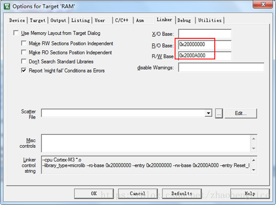

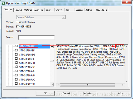

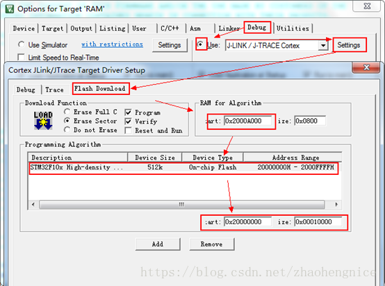

1.     64Kb = 64*1024Byte =0xf10000Byte

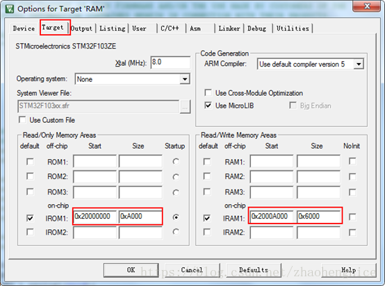

2.将64kB的RAM切割成两份,分别用来存放引导程序和引导程序起作用的缓存区域

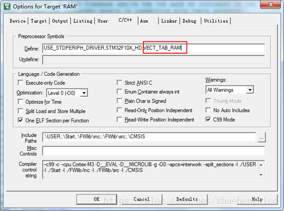

3.在C/C++选项增加个向量VECT_TAB_RAM
4.修改base地址

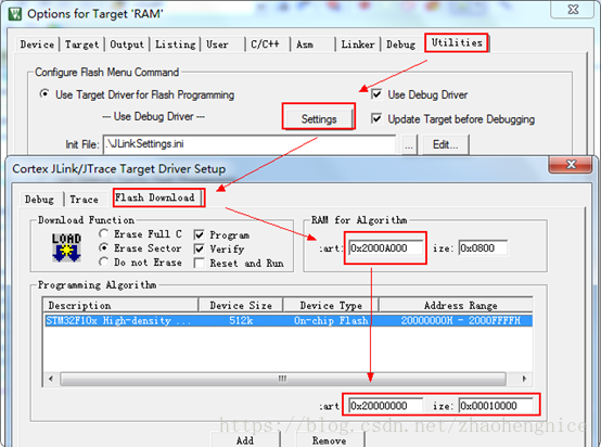

5.设置debug为在线调试方式,注意下面有修改的参数
6.设置调试器,查看已经修改了

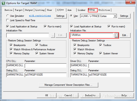

7.     添加RAM.ini初始化文件,文件内容如下:
/* RAM.INI: RAM Initialization File                                           */
// <<< Use Configuration Wizard inContext Menu >>>                           //
/* This file is part of the uVision/ARMdevelopment tools.                    */
/* Copyright (c) 2005-2007 Keil Software.All rights reserved.                */
/* This software may only be used under theterms of a valid, current,        */
/* end user licence from KEIL for acompatible version of KEIL software      */
/* development tools. Nothing else givesyou the right to use this software.  */
FUNC void Setup (void) {
  SP= _RDWORD(0x20000000);          // SetupStack Pointer
  PC= _RDWORD(0x20000004);          // SetupProgram Counter
 _WDWORD(0xE000ED08, 0x20000000);  // Setup Vector Table Offset Register
LOAD RAM\Blinky.axf INCREMENTAL      // Download
//LOAD Output\beep.axf INCREMENTAL
Setup();                             // Setup forRunning
g, main
