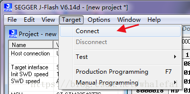

open data file->connect->program->start application
硬件连接完毕

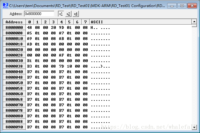

open data file
软件出现文件框

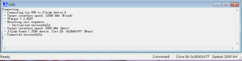

connected
软件显示connected successfully

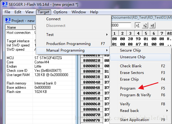

program(不操作此项直接进行下一步硬件无反应)

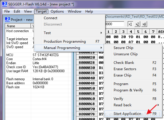

start application
