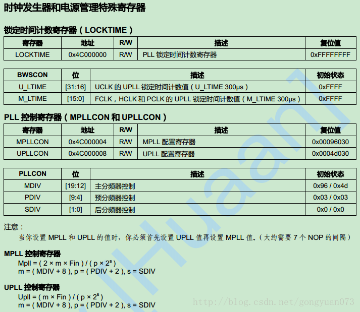

若Fout = 200MHz则, Fout = 2 *m * Fin / (p * 2 ^ s)  = 2 * (92 + 8) * 12MHz / (3 * 2 ^ 2)  = 200MHz
m = 100, MDIV = 92
p = 3,     PDIV = 2
s = 2,     SDIV = 2
#define S3C2440_MPLL_200MHZ     ((0x5c << 12) | (0x01 << 4) | (0x02))
CLKDIVN  = 0x03;            // FCLK:HCLK:PCLK=4:2:1, HDIVN=1,PDIVN=1

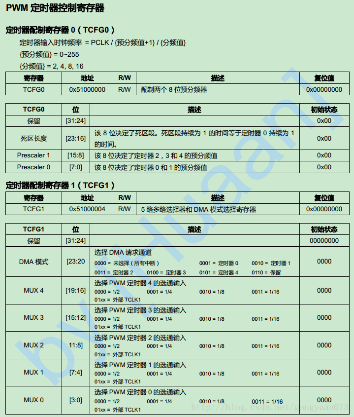

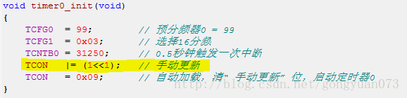

定时器输入时钟频率 = PCLK / (预分频值+1) / 分频值
如: timer0_clock = 100MHz / (99+1) / 16 = 62500Hz
31250/62500=0.5s
必须先设置手动更新,然后再清0
