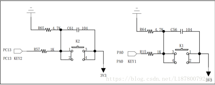

硬件设计:
轻触按键在按下时会使得引脚接通,通过电路设计可以使得按下时产生电平变化。
按键消抖硬件设计

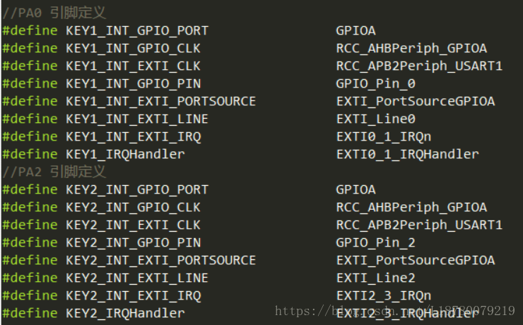

按键和EXTI宏定义:
按键和EXTI宏定义

EXTI中断配置:
/*中断EXTI_PA0配置初始化*/
void EXTI_PA0_Config(void)
    GPIO_InitTypeDef    GPIO_InitStructure;
    EXTI_InitTypeDef    EXTI_InitStructure;
    //时钟使能
    RCC_AHBPeriphClockCmd(KEY1_INT_GPIO_CLK,ENABLE);
    RCC_APB2PeriphClockCmd(KEY1_INT_EXTI_CLK,ENABLE);
    NVIC_Configuration();
    //外部按键GPIO初始化,PA0
    GPIO_InitStructure.GPIO_Pin = KEY1_INT_GPIO_PIN;
    GPIO_InitStructure.GPIO_Mode = GPIO_Mode_IN;
    GPIO_InitStructure.GPIO_Speed = GPIO_Speed_2MHz;
    GPIO_InitStructure.GPIO_PuPd = GPIO_PuPd_UP;
    GPIO_Init(KEY1_INT_GPIO_PORT,&GPIO_InitStructure);
    //将EXTI0指向PA0
    SYSCFG_EXTILineConfig(KEY1_INT_EXTI_PORTSOURCE,EXTI_PinSource0);
    //EXTI0中断线配置
    EXTI_InitStructure.EXTI_Line = KEY1_INT_EXTI_LINE;
    EXTI_InitStructure.EXTI_Mode = EXTI_Mode_Interrupt;
    EXTI_InitStructure.EXTI_Trigger = EXTI_Trigger_Rising_Falling;//下降沿中断
    EXTI_InitStructure.EXTI_LineCmd = ENABLE;
    EXTI_Init(&EXTI_InitStructure);
