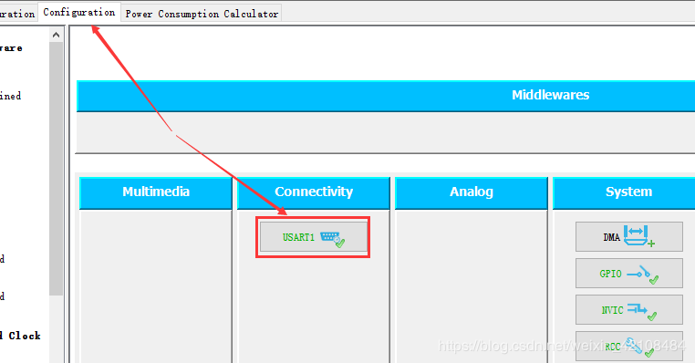

1)首先打开你的工程,在STM32Cube里面找到USART1,此时串口默认是Disanle的,我们要使能它,选择Asynchronous.

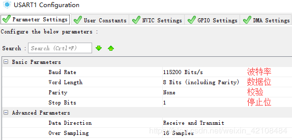

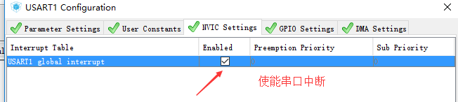

2)然后点击Configuration,就会有一个串口的配置图框,点进去配置串口,如果需要用到中断,选择NVIC进去进行相关配置。
串口配置:
串口中断使能:

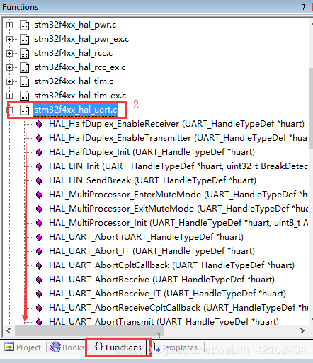

2、查看串口内的函数API
Keil工程内选择{ }Functions,然后选择你需要查看的目标源文件,展开既是该源码内的函数

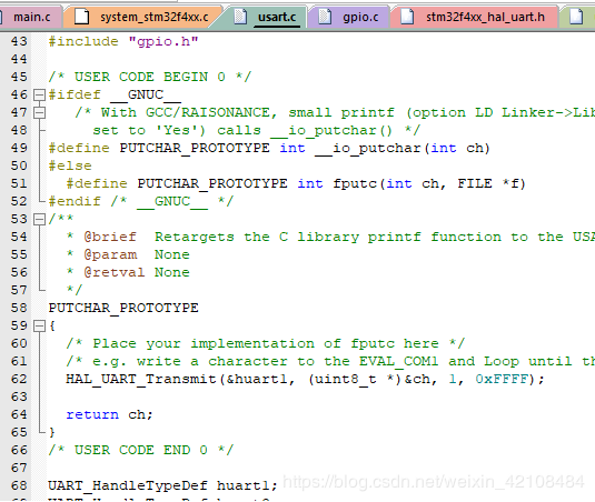

3、在main.c文件添加printf支持
/* USER CODE BEGIN 1 */
#ifdef __GNUC__
       /* With GCC/RAISONANCE, small printf (option LD Linker->Libraries->Small printf
     set to 'Yes') calls __io_putchar() */
#define PUTCHAR_PROTOTYPE int __io_putchar(int ch)
#else
  #define PUTCHAR_PROTOTYPE int fputc(int ch, FILE *f)
#endif /* __GNUC__ */
  * @brief  Retargets the C library printf function to the USART.
  * @param  None
  * @retval None
PUTCHAR_PROTOTYPE
 /* Place your implementation of fputc here */
  /* e.g. write a character to the EVAL_COM1 and Loop until the end of transmission */
  HAL_UART_Transmit(&huart1, (uint8_t *)&ch, 1, 0xFFFF);
  return ch;
/* USER CODE END 1 */

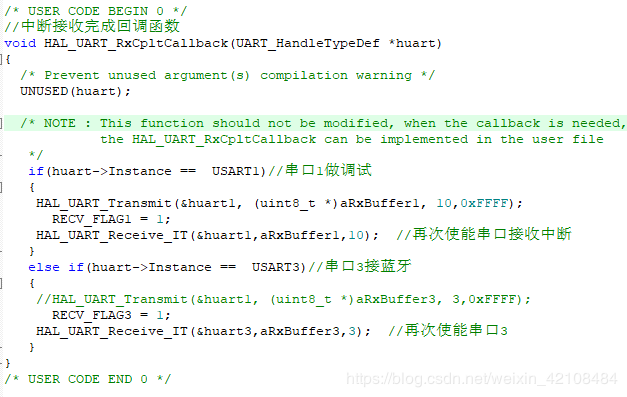

5、多个串口同时使用
1)定义串口1和串口3的接收数据变量
2)中断回调函数
void HAL_UART_RxCpltCallback(UART_HandleTypeDef *huart)
 /* Prevent unused argument(s) compilation warning */
  UNUSED(huart);
  /* NOTE : This function should not be modified, when the callback is needed,
            the HAL_UART_RxCpltCallback can be implemented in the user file
        if(huart->Instance ==  USART1)//串口1做调试
           // HAL_UART_Transmit(&huart1, (uint8_t *)aRxBuffer1, 10,0xFFFF);
             RECV_FLAG1 = 1;
            HAL_UART_Receive_IT(&huart1,aRxBuffer1,10);  // 再次串口接收中断使能
        else if(huart->Instance ==  USART2)//串口2接蓝牙
           HAL_UART_Transmit(&huart1, (uint8_t *)aRxBuffer2, 3,0xFFFF);
             RECV_FLAG2 = 1;
            HAL_UART_Receive_IT(&huart2,aRxBuffer2,3);  //再次串口接收中断使能

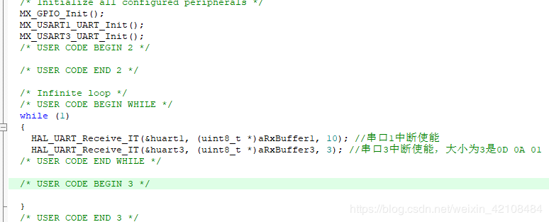

3)主函数编写
Int mai(void)
     While(1)
        if(RECV_FLAG2 == 1)
          RECV_FLAG2= 0;
        Car_contrl(aRxBuffer2[0]);  //控制协议cmd[3]:cmd[0]=控制码  cmd[1]=0xD   cmd[2]= 0xA
    HAL_UART_Receive_IT(&huart1, (uint8_t *)aRxBuffer1, 10); //串口1接收中断使能
    HAL_UART_Receive_IT(&huart2, (uint8_t *)aRxBuffer2, 3); //串口3接收中断使能,所以大小为3:0D 0A 01
