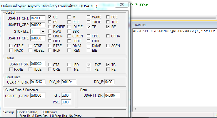

#include "stm32f10x.h"
#include "stdio.h"
void RCC_Configuration(void);//首先设置系统时钟为8MHZ
void GPIO_Configuration(void);
void USART_Configuration(void);
Function Name   : fputc
Description     : 重定向这个C库中的(stdio) printf函数,文件流到串口流USART1
Input           : ch,*f
Output          : None
Return          : None
int fputc(int ch,FILE *f){
  //ch送给USART1
USART_SendData(USART1, ch);  //发送数据
//等待发送完毕
while(USART_GetFlagStatus(USART1, USART_FLAG_TXE)==RESET);
//返回ch
  return(ch);
void delay1ms(u16 t){
    u16 i,j;
   for(i=0;i
     for(j=1000;j>0;j++);
 int main(void){
  u8 i,data='A';
    RCC_Configuration();
    GPIO_Configuration();
  USART_Configuration();
    for(i=0;i<30;i++){
USART_SendData(USART1, data);  //发送数据
    data++;
    //Status = USART_GetFlagStatus(USART1, USART_FLAG_TC);
    while(USART_GetFlagStatus(USART1, USART_FLAG_TXE)==RESET);//USART_SR的TC置一,表示发送数据完成;否则没有完成;
printf("hello");
 return 0;
void RCC_Configuration(void)//系统时钟设置,应用库函数编程过程
//----------使用外部RC晶振-----------
RCC_DeInit(); //初始化为缺省值
RCC_HSEConfig(RCC_HSE_ON); //使能外部的高速时钟
while(RCC_GetFlagStatus(RCC_FLAG_HSERDY) == RESET); //等待外部高速时钟使能就绪
//FLASH_PrefetchBufferCmd(FLASH_PrefetchBuffer_Enable); //Enable Prefetch Buffer
//FLASH_SetLatency(FLASH_Latency_2); //Flash 2 wait state
RCC_HCLKConfig(RCC_SYSCLK_Div1); //HCLK = SYSCLK
RCC_PCLK2Config(RCC_HCLK_Div1); //PCLK2 =  HCLK
RCC_PCLK1Config(RCC_HCLK_Div2); //PCLK1 = HCLK/2
RCC_PLLConfig(RCC_PLLSource_HSE_Div1,RCC_PLLMul_9); //PLLCLK = 8MHZ * 9 =72MHZ,系统给外设的时钟fpclkx
RCC_PLLCmd(ENABLE); //Enable PLLCLK
while(RCC_GetFlagStatus(RCC_FLAG_PLLRDY) == RESET); //Wait till PLLCLK is ready
    RCC_SYSCLKConfig(RCC_SYSCLKSource_PLLCLK); //Select PLL as system clock
while(RCC_GetSYSCLKSource()!=0x08); //Wait till PLL is used as system clock source
//---------打开相应外设时钟--------------------
RCC_APB2PeriphClockCmd(RCC_APB2Periph_GPIOA,ENABLE); //使能APB2外设的GPIOA的时钟
RCC_APB2PeriphClockCmd(RCC_APB2Periph_GPIOC,ENABLE); //使能APB2外设的GPIOC的时钟
RCC_APB2PeriphClockCmd(RCC_APB2Periph_AFIO,ENABLE);
RCC_APB2PeriphClockCmd(RCC_APB2Periph_USART1,ENABLE);
//GPIO_PinRemapConfig(GPIO_Remap_USART1,ENABLE);
void GPIO_Configuration(void)//复用引脚设置
  GPIO_InitTypeDef GPIO_InitStructure;
  /* Configure USARTx_Tx as alternate function push-pull */
  GPIO_InitStructure.GPIO_Pin = GPIO_Pin_9;//复用上拉
  GPIO_InitStructure.GPIO_Speed = GPIO_Speed_50MHz;
  GPIO_InitStructure.GPIO_Mode = GPIO_Mode_AF_PP;
  GPIO_Init(GPIOA, &GPIO_InitStructure);
  /* Configure USARTx_Rx as input floating */
  GPIO_InitStructure.GPIO_Pin = GPIO_Pin_10;//浮空输入
  GPIO_InitStructure.GPIO_Mode = GPIO_Mode_IN_FLOATING;
void USART_Configuration(void)//复用引脚设置
USART_InitTypeDef USART_InitStructure;
USART_InitStructure.USART_BaudRate = 9600;//波特率
USART_InitStructure.USART_WordLength = USART_WordLength_8b;  //8位数据
USART_InitStructure.USART_StopBits = USART_StopBits_1;       //停止位1位
USART_InitStructure.USART_Parity = USART_Parity_No;          //不需要奇偶校验
USART_InitStructure.USART_HardwareFlowControl = USART_HardwareFlowControl_None;//不需要硬件流控制
USART_InitStructure.USART_Mode = USART_Mode_Tx | USART_Mode_Rx;//发送使能,接收使能
USART_Init(USART1, &USART_InitStructure);//初始化
    USART_Cmd(USART1, ENABLE);  //UE使能
