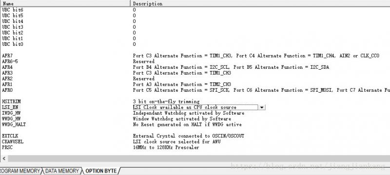

3. 关于LSI的时钟配置为主时钟
void CLK_Config(void)
     CLK_DeInit();   //初始化
    CLK_LSICmd(ENABLE); //使能LSI
    CLK_ClockSwitchConfig(CLK_SWITCHMODE_AUTO,CLK_SOURCE_LSI,DISABLE,
                                            CLK_CURRENTCLOCKSTATE_DISABLE); //切换
   CLK_CCOConfig(CLK_OUTPUT_LSI);    //PC4输出
   CLK_CCOCmd(ENABLE);
这里还需要在STVP中设置OPTION BYTE
LSI_EN     LSI  Clock available as CPU clock source
这样就可以了
