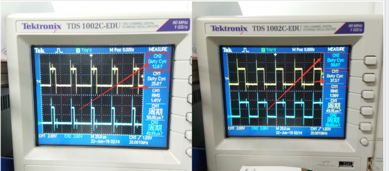

STM32F4 PWM模块探讨

2.定时器相关配置参数
2.1初始化基本定时参数
  * @brief  TIM Time Base Init structure definition
  * @note   This structure is used with all TIMx except for TIM6 and TIM7.
typedef struct
  uint16_t TIM_Prescaler;         /*!< Specifies the prescaler value used to divide the TIM clock.
                                       This parameter can be a number between 0x0000 and 0xFFFF */
  uint16_t TIM_CounterMode;       /*!< Specifies the counter mode.
                                       This parameter can be a value of @ref TIM_Counter_Mode */
  uint32_t TIM_Period;            /*!< Specifies the period value to be loaded into the active
                                       Auto-Reload Register at the next update event.
                                       This parameter must be a number between 0x0000 and 0xFFFF.  */
  uint16_t TIM_ClockDivision;     /*!< Specifies the clock division.
                                      This parameter can be a value of @ref TIM_Clock_Division_CKD */
  uint8_t TIM_RepetitionCounter;  /*!< Specifies the repetition counter value. Each time the RCR downcounter
                                       reaches zero, an update event is generated and counting restarts
                                       from the RCR value (N).
                                       This means in PWM mode that (N+1) corresponds to:
                                          - the number of PWM periods in edge-aligned mode
                                          - the number of half PWM period in center-aligned mode
                                       This parameter must be a number between 0x00 and 0xFF.
                                       @note This parameter is valid only for TIM1 and TIM8. */
} TIM_TimeBaseInitTypeDef;

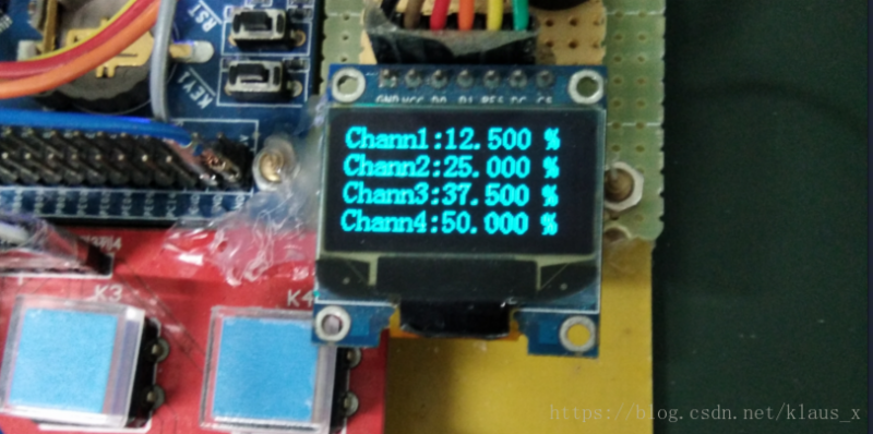

2.2 输出比较参数
  * @brief  TIM Output Compare Init structure definition
typedef struct
  uint16_t TIM_OCMode;        /*!< Specifies the TIM mode.
                                   This parameter can be a value of @ref TIM_Output_Compare_and_PWM_modes */
  uint16_t TIM_OutputState;   /*!< Specifies the TIM Output Compare state.
                                   This parameter can be a value of @ref TIM_Output_Compare_State */
  uint16_t TIM_OutputNState;  /*!< Specifies the TIM complementary Output Compare state.
                                   This parameter can be a value of @ref TIM_Output_Compare_N_State
  uint32_t TIM_Pulse;         /*!< Specifies the pulse value to be loaded into the Capture Compare Register.
  uint16_t TIM_OCPolarity;    /*!< Specifies the output polarity.
                                   This parameter can be a value of @ref TIM_Output_Compare_Polarity */
  uint16_t TIM_OCNPolarity;   /*!< Specifies the complementary output polarity.
                                   This parameter can be a value of @ref TIM_Output_Compare_N_Polarity
  uint16_t TIM_OCIdleState;   /*!< Specifies the TIM Output Compare pin state during Idle state.
                                   This parameter can be a value of @ref TIM_Output_Compare_Idle_State
  uint16_t TIM_OCNIdleState;  /*!< Specifies the TIM Output Compare pin state during Idle state.
                                   This parameter can be a value of @ref TIM_Output_Compare_N_Idle_State
} TIM_OCInitTypeDef;

3.相关要求及测试要点
3.1基本要求
对高级控制定时器进行正确的参数配置,使其输出4个不同占空比的PWM波形,输出占空比值显示在LCD上,并用示波器测量校验。
通道 1 2 3 4
占空比 12.5 25% 37.5% 50%
3.2发挥要求
PWM输出外接控制电路,在不同输出频率下调节占空比,驱动发光二极管控制其亮度,或者驱动直流电动机控制其转速。
输出SPWM信号,用示波器测量并显示。

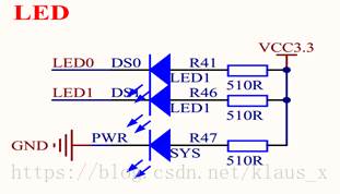

4.硬件设计
4.1LED驱动电路
利用单片机产生得PWM驱动电路直接驱动LED电路来验证,当输出PWM宽度变化时可以看到此时LED亮度变化,此时只需要将LED上拉就可以实现验证。当输入为低电平时,LED灯发光

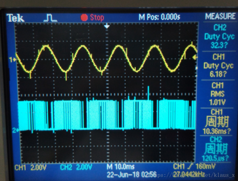

4.2 SPWM滤波方案
利用高级定时器,我们能产生一系列PWM脉宽随时间变化的PWM波形,通过简单的RC滤波就可以将SPWM滤波成正弦波

5.2 占空比实现
TIM3_PWM_Init(arr-1,7-1);//tim3初始化
TIM_SetCompare1(TIM3,duty1);
TIM_SetCompare2(TIM3,duty2);
TIM_SetCompare3(TIM3,duty3);
TIM_SetCompare4(TIM3,duty4);
实验现象对比图
5.3 输出显示
显示代码:
 OLED_ShowString(0,0,"Chann1:",16);
 OLED_ShowFloatNum(56,0,(float)duty1/arr*100,7,16);
 OLED_ShowString(112,0,"%",16);
 OLED_ShowString(0,16,"Chann2:",16);
 OLED_ShowFloatNum(56,16,(float)duty2/arr*100,7,16);
 OLED_ShowString(112,16,"%",16);
 OLED_ShowString(0,32,"Chann3:",16);
 OLED_ShowFloatNum(56,32,(float)duty3/arr*100,7,16);
 OLED_ShowString(112,32,"%",16);
 OLED_ShowString(0,48,"Chann4:",16);
 OLED_ShowFloatNum(56,48,(float)duty4/arr*100,7,16);
 OLED_ShowString(112,48,"%",16);
实验现象图:

5.5 spwm设计
对于高级定时器,可以添加死区
5.5.1 死区初始化
    TIM_BDTRInitTypeDef TIM_BDTRInitStructure;
    TIM_BDTRInitStructure.TIM_AutomaticOutput=TIM_AutomaticOutput_Enable;
    TIM_BDTRInitStructure.TIM_Break= TIM_Break_Disable;
    TIM_BDTRInitStructure.TIM_BreakPolarity=TIM_BreakPolarity_High;
    TIM_BDTRInitStructure.TIM_DeadTime=dead;//¸øËÀÇøÊ±¼ä
    TIM_BDTRInitStructure.TIM_LOCKLevel=TIM_LOCKLevel_OFF;
    TIM_BDTRInitStructure.TIM_OSSRState=TIM_OSSRState_Enable;
    TIM_BDTRInitStructure.TIM_OSSIState=TIM_OSSIState_Enable;
    TIM_BDTRConfig(TIM1,&TIM_BDTRInitStructure);
5.5.2 spwm波表选择
这里我们可以简单的用c语言代码生成对应点数值,生成SPWM波表
float sin_value[672]=
{0.500000,0.504207,0.508415,0.512621,0.516826,0.521030,0.525232,0.529431,
0.533629,0.537823,0.542014,0.546201,0.550384,0.554563,0.558737,0.562906,
0.567069,0.571227,0.575378,0.579522,0.583660,0.587791,0.591913,0.596028,
0.600134,0.604232,0.608320,0.612399,0.616469,0.620528,0.624576,0.628614,
0.632640,0.636655,0.640657,0.644648,0.648626,0.652590,0.656542,0.660480,
0.664403,0.668313,0.672208,0.676087,0.679951,0.683800,0.687632,0.691448,
0.695248,0.699030,0.702795,0.706542,0.710271,0.713982,0.717673,0.721346,
0.725000,0.728634,0.732248,0.735841,
0.304752,0.308552,0.312368,0.316200,0.320049,0.323913,0.327792,0.331687,
0.335597,0.339520,0.343458,0.347410,0.351374,0.355352,0.359343,0.363345,
0.367360,0.371386,0.375424,0.379472,0.383531,0.387601,0.391680,0.395768,
0.399866,0.403972,0.408087,0.412209,0.416340,0.420477,0.424622,0.428773,
0.432931,0.437094,0.441263,0.445437,0.449616,0.453799,0.457986,0.462177,
0.466371,0.470569,0.474768,0.478970,0.483174,0.487379,0.491585,0.495793};
5.5.3 spwm中断程序
void TIM1_UP_TIM10_IRQHandler(void)
    if(TIM_GetITStatus(TIM1,TIM_IT_Update)==SET)
        spwm_duty = 1000*sin_value[cnt++];
        if(cnt == 672)
            cnt = 0;
        TIM_SetCompare1(TIM1,spwm_duty);
    TIM_ClearITPendingBit(TIM1,TIM_IT_Update);
实验现象图
