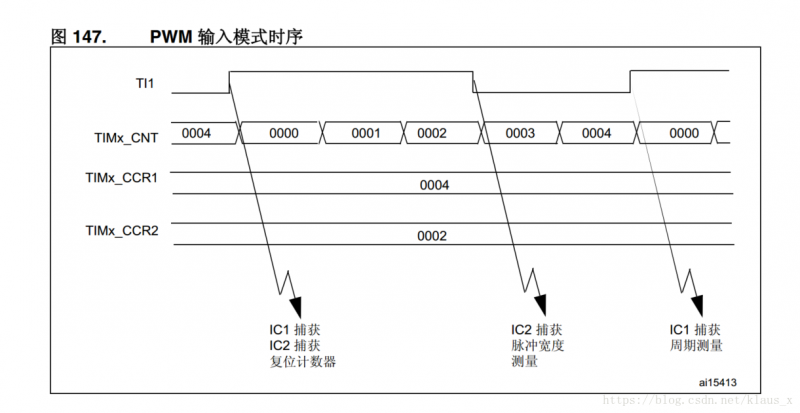

2.定时器捕获模式
定时器功能:测量输入信号的脉冲长度(输入捕获)或者产生输出波形(输出比较和pwm)
2.1 初始化基本定时参数
  * @brief  TIM Time Base Init structure definition
  * @note   This structure is used with all TIMx except for TIM6 and TIM7.
typedef struct
  uint16_t TIM_Prescaler;         /*!< Specifies the prescaler value used to divide the TIM clock.
                                       This parameter can be a number between 0x0000 and 0xFFFF */
  uint16_t TIM_CounterMode;       /*!< Specifies the counter mode.
                                       This parameter can be a value of @ref TIM_Counter_Mode */
  uint32_t TIM_Period;            /*!< Specifies the period value to be loaded into the active
                                       Auto-Reload Register at the next update event.
                                       This parameter must be a number between 0x0000 and 0xFFFF.  */
  uint16_t TIM_ClockDivision;     /*!< Specifies the clock division.
                                      This parameter can be a value of @ref TIM_Clock_Division_CKD */
  uint8_t TIM_RepetitionCounter;  /*!< Specifies the repetition counter value. Each time the RCR downcounter
                                       reaches zero, an update event is generated and counting restarts
                                       from the RCR value (N).
                                       This means in PWM mode that (N+1) corresponds to:
                                          - the number of PWM periods in edge-aligned mode
                                          - the number of half PWM period in center-aligned mode
                                       This parameter must be a number between 0x00 and 0xFF.
                                       @note This parameter is valid only for TIM1 and TIM8. */
} TIM_TimeBaseInitTypeDef;
2.2 输入比较参数初始化
  * @brief  TIM Input Capture Init structure definition
typedef struct
  uint16_t TIM_Channel;      /*!< Specifies the TIM channel.
                                  This parameter can be a value of @ref TIM_Channel */
  uint16_t TIM_ICPolarity;   /*!< Specifies the active edge of the input signal.
                                  This parameter can be a value of @ref TIM_Input_Capture_Polarity */
  uint16_t TIM_ICSelection;  /*!< Specifies the input.
                                  This parameter can be a value of @ref TIM_Input_Capture_Selection */
  uint16_t TIM_ICPrescaler;  /*!< Specifies the Input Capture Prescaler.
                                  This parameter can be a value of @ref TIM_Input_Capture_Prescaler */
  uint16_t TIM_ICFilter;     /*!< Specifies the input capture filter.
                                  This parameter can be a number between 0x0 and 0xF */
} TIM_ICInitTypeDef;
定时器输入捕获模式可以来测量脉冲宽度或者测量频率

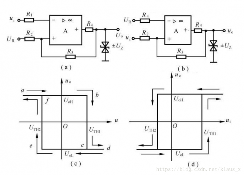

5.1 电压比较器电路
电压比较器的功能是对两个输入电压的大小进行比较,并根据比较结果输出高低电平。
       通常用阈值电压和传输特性来描述比较器的工作特性。 阈值电压(又称门槛电平)是使比较器输出电 压发生跳变时的输入电压值,简称为阈值,用符号UTH表示。估算阈值主要应抓住输入信号使输出电压发生跳变时的临界条件。这个临界条件 是集成运放两个输入端的电位相等(两个输入端的电流也视为零),即U+=U–。

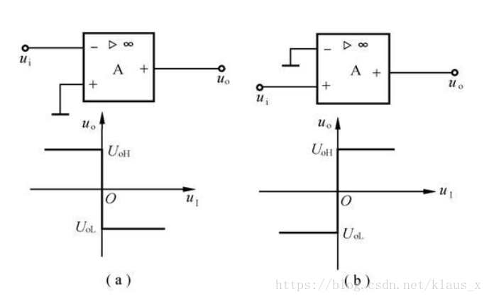

5.1.1 零电平比较器(过零比较器)
电压比较器是将一个模拟输入信号ui与一个固定的参考电压UR进行比较和鉴别的电路。  
       参考电压为零的比较器称为零 电平比较器。按输入方式的不同可分为反相输入和同相输入两种零电位比较器

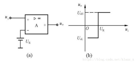

5.1.2 任意电平比较器(俘零比较器)
将零电平比较器中的接地端改接为一个参考电压UR(设 为直流电压),由于UR的大小和极性均可调整,电路成为任意电平比较器或称俘零比较器。
5.1.3 滞回电压比较器
滞回比较器又称施密特触发器,迟滞比较器。这种比较器的特点是当输入信号ui逐渐增大或逐渐减小时,它有两个阈值,且不相等,其传输特性具有“滞回”曲线的形状。
       滞回比较器也有反相输入和同相输入两种方式。   
       UR是某一固定电压,改变UR值能改变阈值及回差大小。

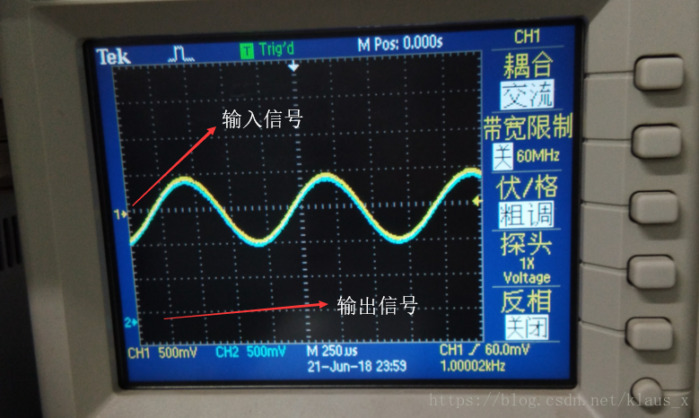

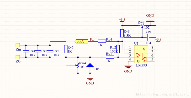

本次中,我们选择电力电子中常用的LM393比较芯片,下图为比较原理图
在输入端,我们直接输入交流正弦型号,,Dz稳压二极管会将电压抬至一定高度,供芯片比较。
       如下图所示

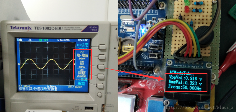

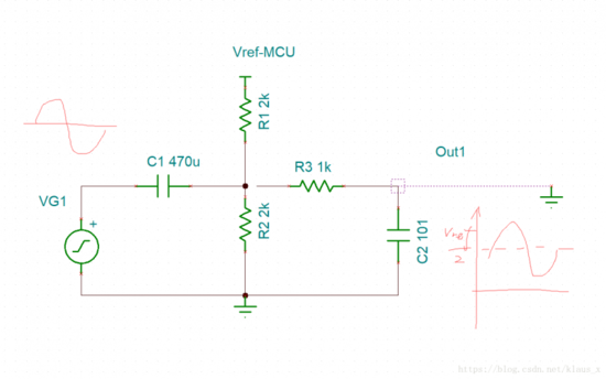

5.2 交流采样电路
当输出电压、电流是双极性的交流信号,AD只能采单极性的交流信号。采用如下图所示的直流偏移电路可以把信号转换一下。
电解电容C取470uF/16V,R1、R2取2k,这样高通截止频率为2Hz左右,用于采样20Hz以上的信号。
计算过程中,先用求平均的方式把直流偏置算出来,然后扣除该值就得到交流信号的实际值了。不过要注意这部分电路要放尽量在单片机那头。

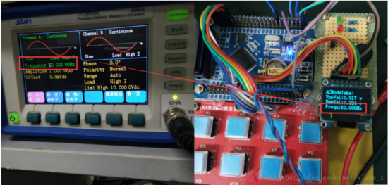

6.软件设计
根据题目要求,我们配置ADC成ADC1和ADC2双重模式,即由主ADC1带动从ADC2进行交替采样,详细代码见源文件,具体配置过程参照前面博客,这里是链接。

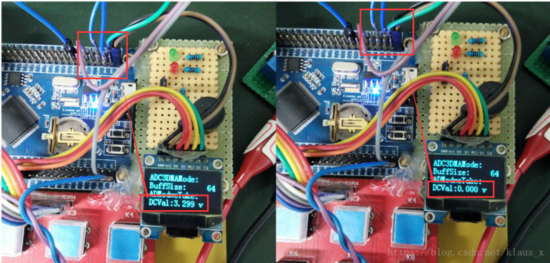

6.1 直流采样问题
直流采样,让ADC一直循环取值,相关程序如下

我们直接将采样引脚连接到3.3v和0vde得到如下结果

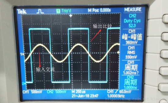

6.2 交流频率测量
对于测交流正弦波信号的频率,我们将双极性的正弦波通过电压比较整形成脉冲波供单片机采样。

相关计算频率过程代码如下
相关计算频率过程代
void TIM2_IRQHandler(void)
    if(TIM_GetITStatus(TIM2, TIM_IT_CC2) != RESET)
        TIM_ITConfig(TIM4,TIM_IT_Update,ENABLE);
        //ADStartTim4Flag=1;
            TIM_ClearITPendingBit(TIM2, TIM_IT_CC2);
    IC2Value=TIM_GetCapture2(TIM2);
    IC1Value=TIM_GetCapture1(TIM2);
    //GPIO_SetBits(GPIOD,GPIO_Pin_1);
    if(IC2Value!=0){
        DutyCycle=(float)IC1Value*100/IC2Value;
        Frequency =(float)1000000/IC2Value;
    else{
        GPIO_ResetBits(GPIOD,GPIO_Pin_1);
        DutyCycle=0;
        Frequency=0;
    TIM_ClearITPendingBit(TIM2, TIM_IT_Update);

对于交流采样,采取的是同步采样过程,具体步骤是电压比较电路触发定时器TIM4实时,定时器根据输入信号频率计算定时间隔,等间隔采样。

OLED_ShowString(0,0,"ACModeTake:",16);
OLED_ShowString(0,16,"VppVal:",16);
OLED_ShowFloatNum(56,16,VppValue,7,16);
OLED_ShowString(104,16,"v",16);
OLED_ShowString(0,32,"RmsVal:",16);
OLED_ShowFloatNum(56,32,ADVoltage,7,16);
OLED_ShowString(104,32,"v",16);
OLED_ShowString(0,48,"Frequ:",16);
OLED_ShowFloatNum(48,48,Frequency,7,16);
OLED_ShowString(96,48,"Hz",16);
实验现象图
至于造成峰峰值不准的原因是:没供地,即博主单片机是电脑jlink供电,电路是电源供电,输入信号是信号源供电,三者地没有连在一起。
